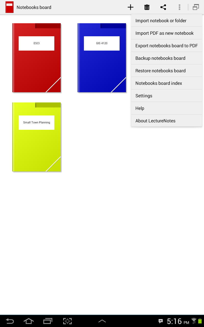

We're going to begin by selecting settings from the LectureNotes drop down menu (three vertical bars at the top right).
