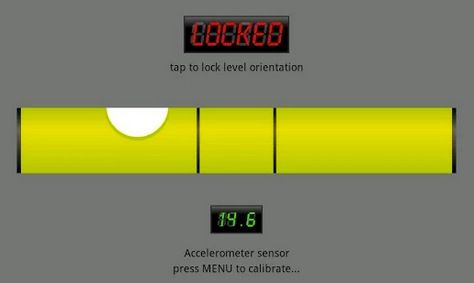

- Buy, have or borrow a small, robust computer that has a built in tilt-sensor (bonus if it can send text messages and tweet). Then download a digital level app such as iHandy Level Free for iOS or Bubble Level for android.
- Alternately, buy, have or borrow a digital level.
- Zero your level against a flat, horizontal surface, then mount your level on the crank arm. Use tape, glue (no, not glue), a custom 3d printed snap-on mounting device, or just be prepared to hold it there like I did.
- Make some test bends, taking note of the angle on your level. It doesn’t directly reflect the angle you are bending to, ie, if it says 20 degrees, you have not made a 20 degree bend. There is a correspondence between the angle of the crank arm and the angle of the bent piece: If your level says 20 degrees, and your piece of metal is bent to 45 degrees, you can make more 45 degree bends by lowering the crank arm to 20 degrees, as long as it’s the same type of metal with the same thickness and width. To know exactly what angle you've bent, you'll need to take out your bent piece and measure the angle.
