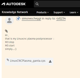

Step 3: Post Processor
You'll need a post processor for LinuxCNC. The standard post processor in Fusion 360 will give you an error message when you try to post with it. With some searching I found this post processor that worked perfectly without any modification for me. https://forums.autodesk.com/t5/hsm-post-processor-forum/linuxcnc-plasma-laser-post-processor/td-p/8112836 Scroll down until you find the downloadable post processor called Linuxcncplasma_ganta.cps. Download this and add it to the Fusion 360 library of post processors.
