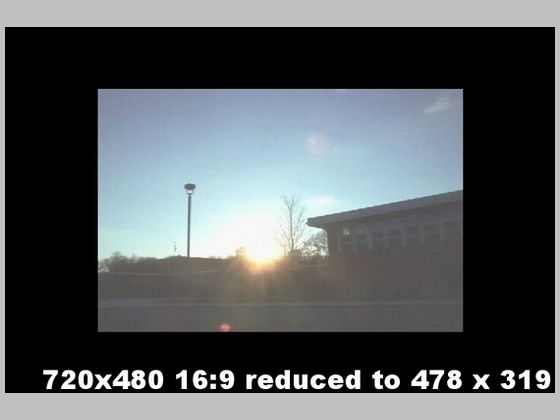

First, study the Example Image below.
It is a 720 x 480 Video Frame, with a 120 x 80 Bug in the Lower Right Corner.
It was positioned with an X [Horizontal] number, and a Y {Vertical] number.
It was sized with Width number, and a Height number.
These 4 numbers [X], [Y], [W], and [H] are included in string as follows:
<Param name="LogoRect" value="0.7750 0.7500 0.1666 0.1666"/>
These 4 numbers are all proportions of the Video Frame width [720], or Video Frame height. [480].
They are not the actual pixel counts. They are all proportional values so that they will work across all video sizes that you may decide to use.

Step 8: Calculate the X [Horizontal] Coordinate, for Your Bug
Your Bug Image can be displayed at any size or position, on your frame. Once you realize this the possibilities are endless. You might even try to imitate the 1/3 Frame overlays that you might see on an Infomercial!
The first number in the string is the X [Horizontal] [YELLOW] coordinate.
We want the Bug to be 40 pixels from the Right edge of the Video Frame.
Therefore we'll subtract 40 pixels from 720 pixels=680 pixels
Our Bug will be 120 pixels wide [regardless of what size you Bug Image is as a file].
Therefore we'll subtract 120 pixels from the remaining 680 680-120=560 pixels.
Now we'll find what proportional part of the 720 Video Frame is this 560, because 560 pixels is the distance from the left edge of the Video frame to the left edge of our Bug.
560/720=0.7777 [In my example file, I rounded it to 0.7750, It was my choice.]
