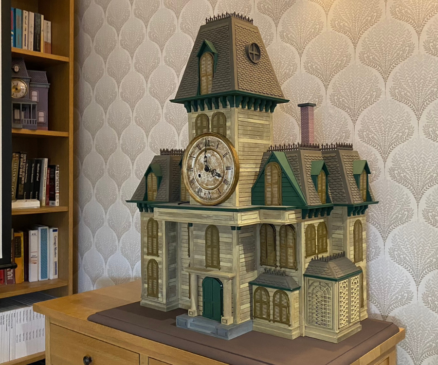

If you've ever watched the 1991 Addams Family Movie then you must remember the amazing clock that appears in the opening scenes of the film. It was a miniature version of the Addams Family Mansion. The automaton clock was specially constructed by a movie prop company and it cost thousands of Dollars to produce, however, it wasn't actually a real clock, it was just a movie prop operated by technicians on the set.
Now you can build your own Addams family Clock and it won't cost you thousands.
This instructable contains plans and instructions showing you how you can make your own mini version of this famous movie icon.

Clock Insert
Slide your clock insert into the tower (be careful not to scratch the artwork on the balcony)
Make a Base
You can also make a wooden base for the clock if you wish.
Step 8: Admire Your Finished Clock
WELL DONE!
Your Addams Family Clock is now complete.
