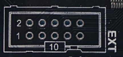

4. Viola, You now have access to the custom Melzi inspired board. The only reference to this board is V5.1. There is currently no name for it, However, everything is almost identical to a newer style Melzi. You will notice that your Printer may look slightly different from mine. That is due to the fact I have installed a secondary board for handling the current to the heated bed platform. (you can find more information on google) but for reference, I used this module, With this Bracket.

2. The first thing you're going to want to do is to move the Jumper I have highlighted in the pictures, from behind the Z Probe Connector. It is by default on the back right side behind pins 2 and 3. We need to De-Solder this jumper and Re-Solder it to the other side between pins 1 and 2. Doing this will bring the VCC voltage on pin 1 of the connector down to 5 Volts from 24!. Very important or we will break things! I just bridged the connection using solder because I find that easier. you can do whatever you feel comfortable with.
3. Once the Jumper is Removed, We can now solder on either a JST Header or just solder 3 wires to the board. Up to you.
4. With the jumper on the left and 3 wires soldered, we are now going to want to put a 10K Resistor between the Signal Wire and the Ground Wire. AKA Pin 2 and Pin 3. (or Arduino Pin 25 and GND) We need this resistor because the pin tends to "Float" between ground and 5 volts. Thus it gives us incorrect triggering of the Z-Probe. I Have covered all of my connections with shrink tube but hopefully, this step is self-explanatory.
(for those of you familiar with Arduino, this board would have needed an external pull-up or pull-down resistor regardless of the configuration. for whatever reason this board is noisy.)
5. Now that the Connections are made, our jumper is moved, and our resistor is in place...We're done!! Well Kinda. We need to zip tie any loose wires, get the signal and 5v wires ran to the extruder, and our screws back in!
