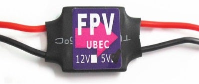

  1. Step-down DC-DC converter (Fixed 5V output). I bought mine from Banggood for 2.27$ shipping included, #SKU151702.

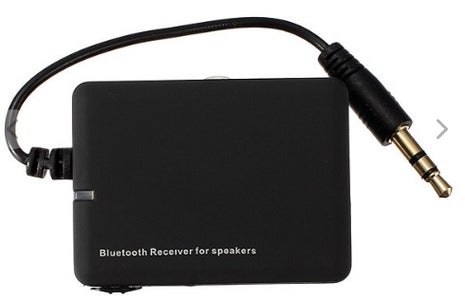

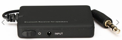

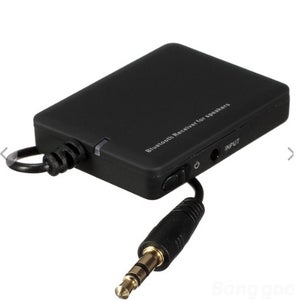

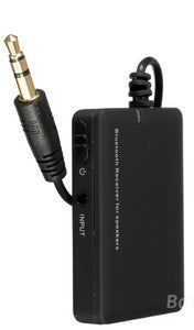

  2. A2DP Bluetooth receiver with 1/8" analog audio output. I bought mine from Banggood for 8.83$ shipping included, #SKU151813. Note that the input shown on the product's photos is the power input. [EDIT]The module I used in the first place included an internal battery and was not booting correctly all the time. I switched to a USB-powered dongle without internal battery instead and now it works like a charm. You can get those USB-powered A2DP with 1/8" audio output on eBay for around 4$ including shipping. Typically the rectangular black device like shown in the photos is NOT what you want, I tried them and they do not work. Get a dongle that looks like a USB thumb drive with a 3.5mm (1/8") audio output.

In the package received with the Bluetooth receiver, there was a USB to barrel connector cable. This is the cable I'm using to charge and power the receiver. Cut the USB head off of the cable and strip it. Cut both ends off of the DC-DC converter and strip the ends. Solder the cable that came with the receiver to the output of the DC-DC receiver such that the DC-DC is powering the receiver. Use some heat shrink tubing on the wires to make a clean and safe job.
