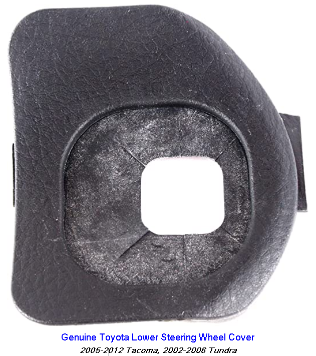

Other's worked around that expense, as I did purchasing the after-market third-party control switch and modifying the existing cover on the steering wheel (I bought a cover designed for the switch) to accommodate the CC Switch mechanism.

Steering wheel cover plate - Amazon

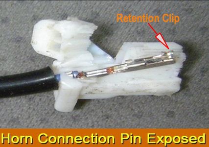

My advice is to try "whatever" - but do NOT DAMAGE the metal connector within that holder! In my case, I carefully removed / shaved, actually cut slices of the nylon holder until i was able to free the metal connector. I still don't know how it could be released otherwise, but will not swear it cannot be done. The factory alternative in this case would have set me back over twice what the switch and cover cost me!

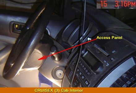

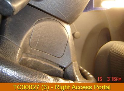

Crawl on the floor or turn the wheel to gain access to an Access Port There - are two of these. They are identical (note their orientation) and are removed the same way. The image titled Prying open the left access port has the engine compartment at Left and the Driver's seat RIGHT. The pry tool, in this case a dental pick (but a a screwdriver or nylon pry tool would do as well or better) is inserted at the right edge and that edge is pried open and leaps to the floor.

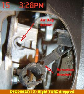

Next, loosen the TORX bolts that secure the AIR BAG - first one side and then the other. They have plastic retainers that SHOULD hold them in place once they have been completely unscrewed - but one of mine dropped to the floor. I picked it up and returned it to the retainer

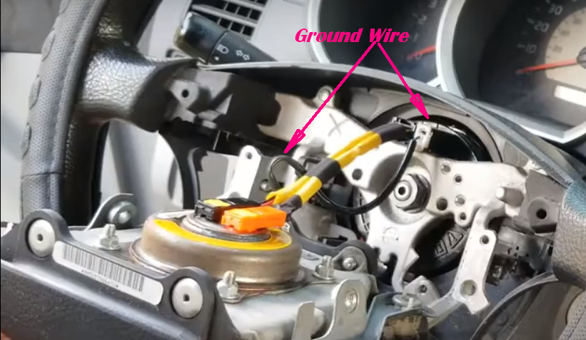

Once the two TORX bolts have been 'undone,' gently lift the AIR BAG assembly up at rotate it up and over so it might rest on top of the steering column. You DO NOT NEED to remove the yellow wire connections to the Air bag - just the little black 'ground' spade connector that we will reuse in another step.
Note the retention bit on that spade connector pry it up/open a bit to release the connector.

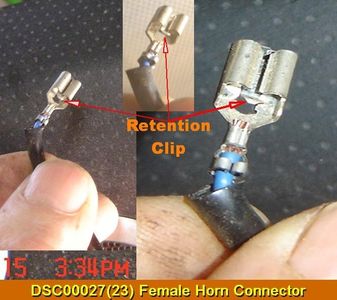

Indeed, this little ground wire with the nylon fitting on one end and a 'silver' spade connector on the end that attaches to the airbag will consume lots of time and effort - if you let it.
It is where I wasted thirty minutes or so attempting to extricate the metal connector from the nylon fitting that plugs into the steering column and connects the new cruise control switch and the AirBag/Horn ground to the vehicle's factory wiring. Without that ground wire, you will not have a working horn - not clear if the AirBag depends upon it,

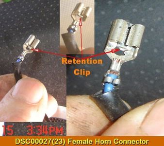

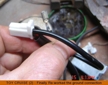

Step 4: Recycle the Horn/Ground Connector

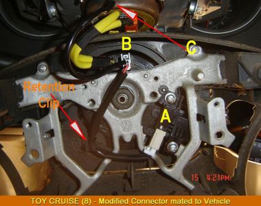

Having removed the ground/horn connector (B) from the Air Bag and the nylon connector on the steering wheel, I had two male nylon connectors that fit into the female receptacle on the steering wheel. (See Image "AirBagGroundWire 220530")
They were identical four-hole connectors with but one and two leads, respectively, in each. The blue ground/horn wire (B->C) was fitted into the upper left opening while the black and red wires from the Cruise Control Switch (A->B) occupied the lower left and right openings of the connector that came with the switch.
What needed doing was removing the blue lead from it's male connector so it could be inserted into the upper left opening of the male connector that came with the switch. See image "Toy Cruise (8) - Modified connector mated to vehicle."

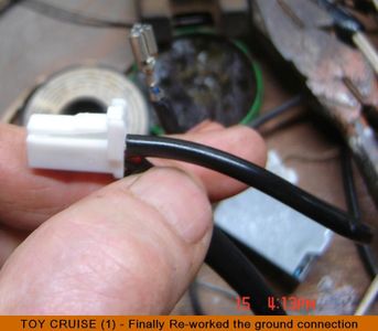

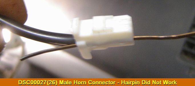

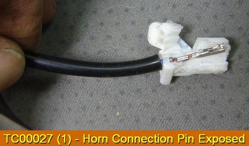

For the life of me, I could not McGiver the metal connector (on the blue lead) out of its nylon fitting. Maybe there is a special tool available. I was touted onto a hair pin in some YouTube Video and borrowed one from the wife to no avail.
Now Toyota sells a little 'harness' that has the ground spade and the two nylon retention fittings all wired up - and it simply plugs into the cruise switch, the steering column and onto the spade terminal on the air bag - lickety split - It'll set you back about sixty dollars before tax.
However, since we already have a harness with the two essential nylon retention fittings attached and we have a ground wire with the appropriate connectors factory fitted in place, it makes sense to extricate the old ground wire from the retention fitting and slip it into the appropriate opening on the new retention fitting.
Ultimately, I cut the connector out of its nylon fitting without damaging it in the process. NOTE: PAY ATTENTION TO THE ORIENTATION of this connector as you extricate it from its fitting so as to insert it into its new home in the same orientation as it enjoyed in its old fitting.
See image Toy Cruise (1)
Congratulations skinflint! - you have created a $50 'factory' wiring harness for (essentially) free!

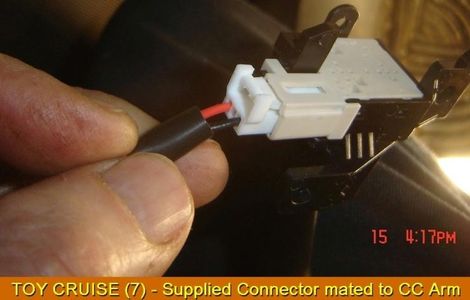

Step 5: Install New Cruise Switch

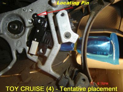

Look at image "Toy Cruise (4) - Tentative Placement" to see how the switch was inserted 'handle first,' then slipped over/onto the locator pin, then fastened to the metal bracket with the two small machine screws included with the switch.
That's it! Now take the wiring harness as modified in the previous step and plug the three-hole male connector into the switch receptacle. Route the wires (see image Toy Cruise (8)) as shown through the retention clip and into 4-hole female connector "B" and rout the blue ground/horn lead up and onto the male spade connection on the Air Bag - Note the retention clip on the female spade connector.

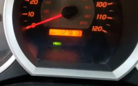

You could connect the battery at this point, press the cruise control switch button to see if the word 'cruise' lights up as in the image "Cruise Lights."
However, I thought the better of powering up the system with the Air Bag laying on top of the steering wheel, so I checked all my connections and re-installed the Air Bag, before testing it.
It worked, the light lit and, when I went for a ride, the Cruise works. That was weeks ago. It still works.
