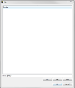

Step 5: Adding Symbol to Library
Now that we have copied the symbol we want we can add it to our library.
In order to do this we have to go back to the Eagle home and re-open the library we created for our part.
1. Double click on the folder we created earlier.
2. Double click the library we created.
3. Click on the symbol icon.
A pretty bare box should pop up.
4. Enter the name we would like to call our symbol and click ok.
I have decided to call my symbol OPAMP to keep things simple.
5. You'll get a warning asking if you want to create a new symbol. Click yes and the a blank grid should appear.
6. Can click the paste icon and the symbol we copied should appear in the grid.
Now we can edit the symbol however we like. Personally I like to remove the SpiceOrder's and rename the pins so they make sense to me but this is optional.
7. Once you are happy with the symbol click File => Save and close the window.

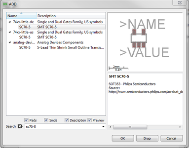

Step 6: Getting the Package
Now is when the datasheet for your component becomes important.The datasheet of the MCP6001 shows many different packages available but for this instructable I'll focus on adding the SC70-5 package.
To get the package we'll go through a roundabout process that will make our lives a little easier.
1. On the Eagle home page click File => New => Board.
2. On the new window click the add button.
Here we can search for the package we need.
3. Type the name of the package you want and hit enter.
A list of parts with the same package will appear.
4. Once you find the same package place the component anywhere on the board.
Note: The add icon is again called out in a picture.
Troubleshooting: If you click the add icon and search for a package and can't find the same package then one of three things happened
You may have entered the name of the package slightly wrong. Eagle can be very picky about how things are spelled including capitals so make sure to check what you searched for.
Eagle doesn't have a component with the package you want and you'll have to create the package by hand which is outside the scope of this instructable.
You need to add the libraries you want to search through to the Eagle part list. This can be done by clicking on Library => Use, and then selecting all the libraries and clicking open.

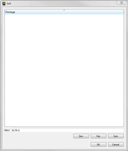

Step 8: Adding the Package
Now we can add the package to our custom library
1. Re-open the library we made
2. Click the package icon.
3. give the package a name.
You'll get a warning asking if you want to create the new package click yes.
4. Click the paste icon
Your screen should look like the picture above.
5. (Optional) Go around the package and rename each pin so you can more easily find them later.
6. When done click File => Save.
Note: There is an origin symbol on the grid when copying things in. Eagle sees this as your device when placing components on the board so keeping the package centered around it is recommended.

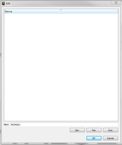

Step 9: Connecting Pins and Pads
We're almost done. All we have left to do is connect the schematic to the package so Eagle knows where things should be connected when laying out our board.
1. Click on the Device icon and enter the name of your device.
You should end up with a window similar to the one above.

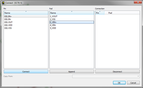

2. Click on the add a symbol button.
3. Select the symbol you created.
4. Click New in the lower right comer
5. Select the package you copied in.
The window should now look like the third picture.
6. Click connect in the lower right corner.
If you named everything the same way you should be able to just select the similarly named things and connect them.
7. Click File => Save.
