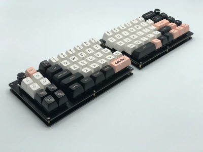

I have a really nice keyboard, a Quefrency split keyboard from Keeb.io. I like it because it is "normal enough" for my old hands' muscle memory but splits to keep my arms from getting messed up with carpal tunnel. The one thing I always craved was more use of my thumbs, as I use the control and option keys a lot and don't like putting my thumb waaaay back to reach them. So I finally got a 3d printer and decided to modify it.

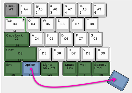

The first thing I had to do was design and print the part that will hold the key to the keyboard. The Quefrency has a number of possible configurations. Because of this, if you go to its page there are links to the Keyboard Layout Editor (KLE) file. KLE is a web based tool specific to laying out keyboards. If you are adding to your store bought 65% or 104 key (really or nearly anything else) you should be able to find a layout for it. I opened this, chose my configuration, and then added my key. If you are not familiar with it, but are wanting to modify keyboards, you should be. Note that everything is done on a grid of "u"s, or units, with a normal letter key being 1u wide and 1u tall.
I opened the link, adjusted it to my configuration pre-additional button, and, well, added the buttons. For this we'll just stick to the left side.

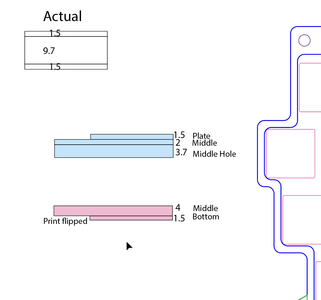

Step 5: Determine Thicknesses
So we have all the layers in Illustrator, but when we bring it to TinkerCAD we'll need to make them a specific thickness. For me, that meant measuring the thickness of the plates (1.6 mm - typical is 1.5 for plates?) and the gap between (9.7mm). Using this, I came up with a plan for how divide up the layers and how thick each needs to be.
For sake of my visualization (and now yours) I sketched it out in Illustrator.

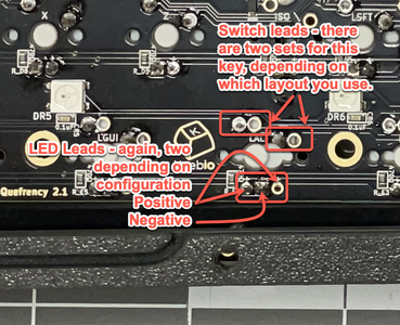

First, I will add only the top layer with the switch installed. The design will allow wiring it up with the channel exposed, then the next layer covers it up.
A note: my keyboard has LED backlighting, so I added an LED to my switch using BluTack.
  1. Blu Tack the LED into the switch. Other ways could include chewing gum, hot glue... I haven't tried any of it. Also, this seemed to work fine for me, but ymmv with the board supporting adding another LED in parallel to an existing one.
  2. Said switch goes into the top layer.
  3. Remove the bottom plate and add that layer of the mid-section, slipping it onto the existing stand-offs.
  4. Using very small wire, connect the switch to the existing switch holes (or in my case the additional ones) and the LED into it's twin's holes. Note LEDs have polarity, so big lead to +, short lead to -. For the switch, we're just shorting the pins (when pushing the key) so it doesn't matter which goes to which.
Given it is so small, fiddly and we're soldering to existing soldered points, the addition of a bit of flux from a flux pen is helpful. Watch carefully for shorts - my soldering iron was likely set too hot, so I melted the insulation on my tiny wires, so I added some electrical tape. Had I anticipated this I could have used shrink tube, or one could use liquid electrical tape.
