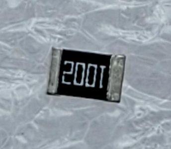

  10. 10Kohm 0805 SMD resistor (2)

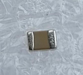

  11. 10 uF 0805 SMD ceramic capacitor
  12. 0.1 uF 0805 SMD ceramic capacitor
