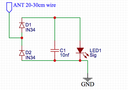

Step 2: Building the Signal Strength Indicator
It's useful to have a simple way of knowing the peak output of the board. This simple LED circuit uses two germanium diodes as a voltage doubler and a capacitor to rectify this to DC, finally an LED to show the relative output.
Non of the components are critical, you can use silicon diodes at a push, but germanium gives better results. The LED, a RED is better - it has a lower operating voltage.
As you can see from the above picture construction is a simple case of joining the diodes cathode to anode, then solder the capacitor and LED in place. No PCB or prototype board is needed, of course you can use one if you want.
The small aerial (20-30cm of wire connected to the junction of the diodes) just hangs free.
To test it hold the cathode side of the LED, turn on the modulator and bring the wire aerial near the modulators aerial. It should light dimly.
When you adjust the output, later in this article, keep the distance between the aerials the same - so as not to effect the brightness of the LED except with adjustment.

Remove the audio lead. Connect the cathode to the ground pin on the audio pins (use a crocodile jumper lead etc). Keep the 20 cm aerial a few centimetres from the main aerial and adjust the trimmer for the best LED output.
