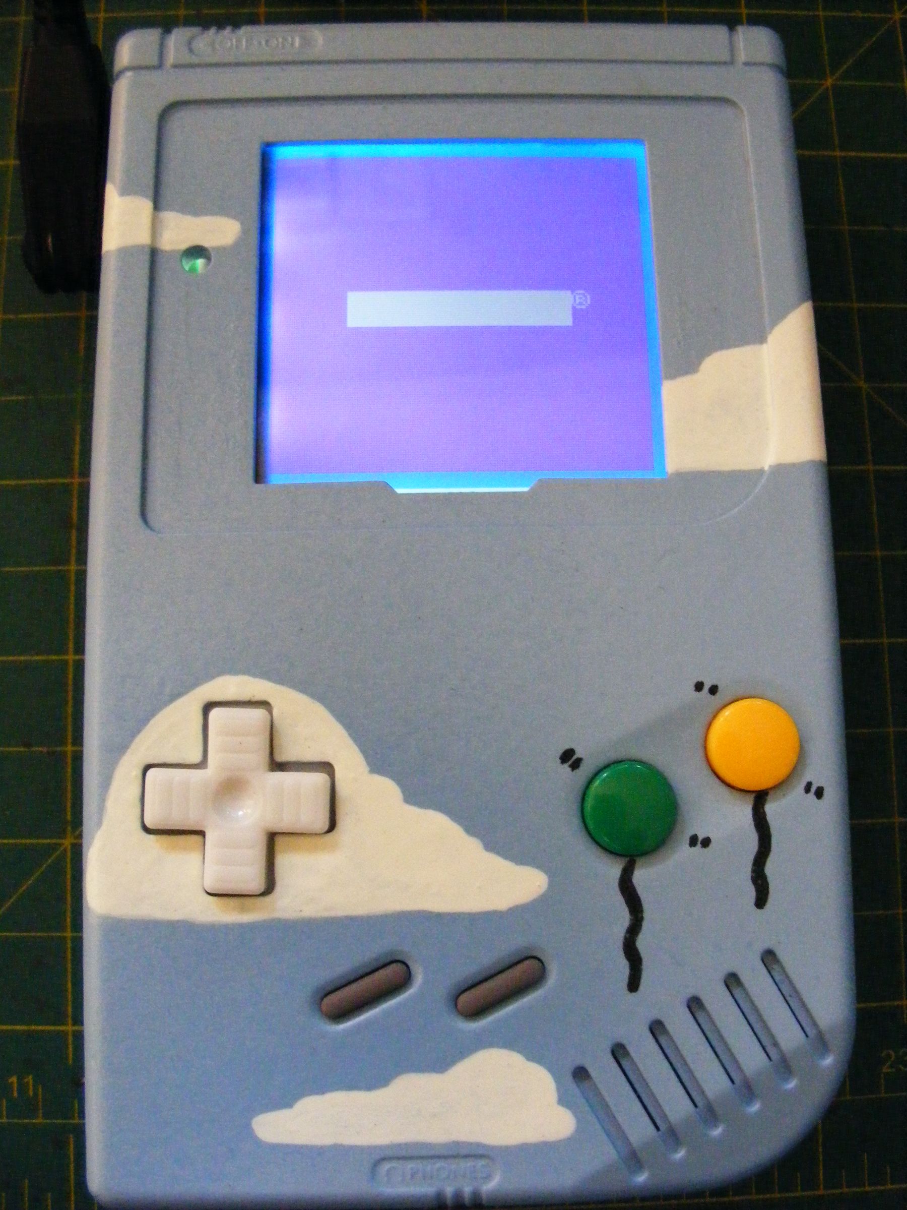

...from here there are some cool things you can do
-A custom paint job has been known to really put a customized look on these carts
