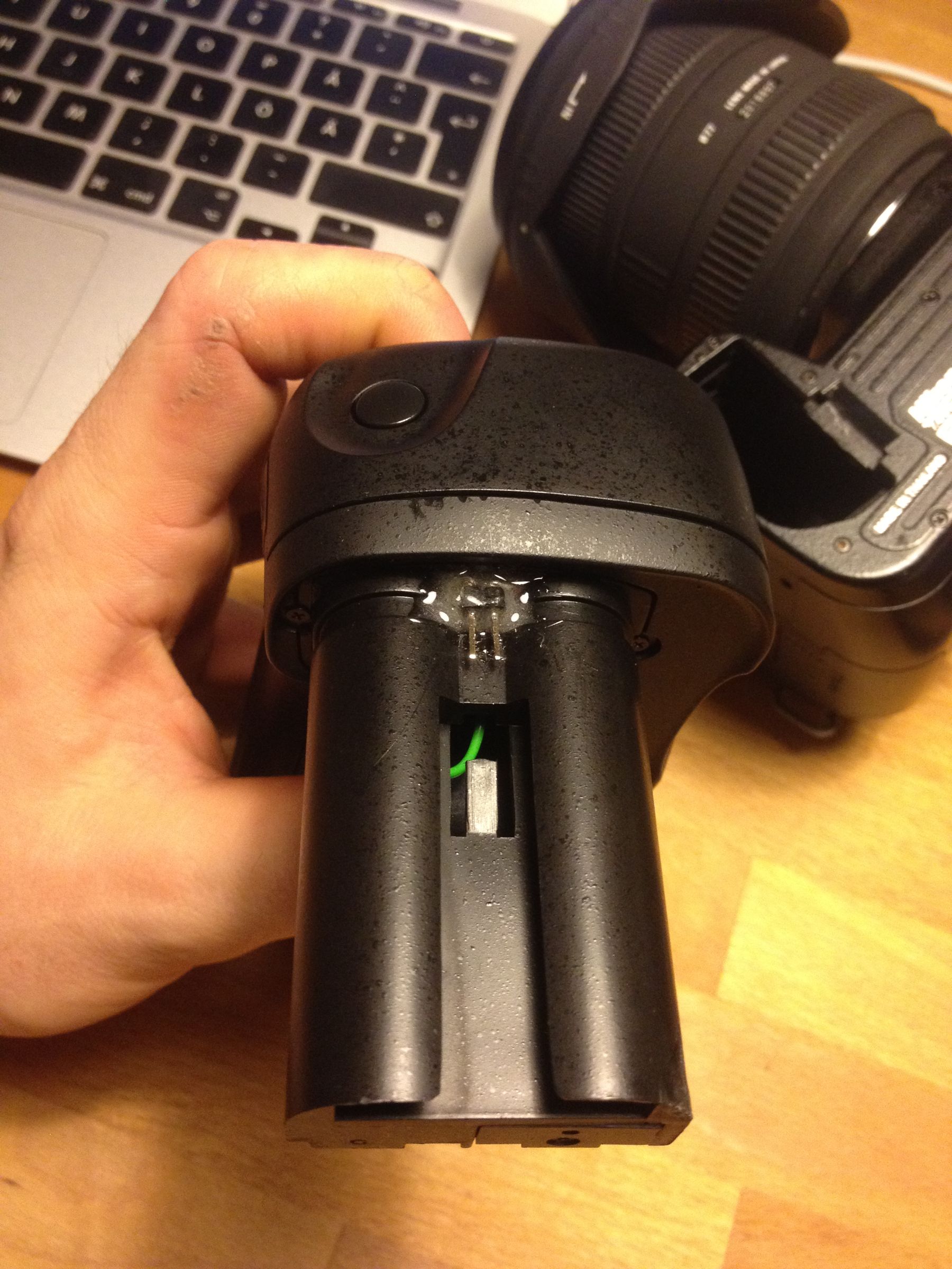

Step 3: Later (battery-grip) Mod Preparation
To prepare for my later ”battery-grip mod” I had to make room for 2 wires down the battery-tray.
