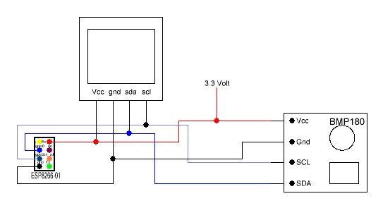

After adding an RTC and an OLED to the ESP8266-01 through I2C, I presumed it should not be too difficult to add a BMP180 sensor as well, in spite of coming across some postings on Internet of people not succeeding.
My BMP180 module -from my Arduino days- was a 5 Volt module, which made me think I may need a level shifter, which would be a pity as the BMP180 is in fact a 3.3V chip.
The circuit of my BMP180 module shows that the I2C pull up resistors (4k7) are in fact connected to the 3.3 V line that is provided by a 662k (as was to be expected). This meant that even if I fed the module with 5 Volt, I would not need a level shifter. And as the 662K is a low drop regulator and the BMP 180 also works with voltages lower than 3.3, I presumed I didn't need 5 Volt whatsoever
The connection of the BMP180 is simple Vcc to Vcc, Ground to ground, SDA to SDA and SCL to SCL. On the ESP8266 I am using GPIO0 as SDA and GPIO2 as SCL

Step 1: The Connections
This couldn't be simpler:
I used GPIO0 as SDA and GPIO2 as SCL. The BMP180 and OLED have the pin nominations clearly stamped on them so you only need to connect as follows All Vcc-s together All Grounds together BMP180 and OLED SDA pins to GPIO0 BMP180 and OLED SCL pins to GPIO2 Finally connect the CH_PD pin with Vcc Make sure you identify the proper pins. Your modules may have a pin sequence that differs from mine
