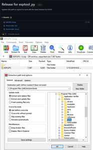

Step 4: Install ESP32 Filesystem Uploader
The primary purpose of the ESP32 Filesystem Uploader is to let you upload files into ESP's filesystem. In this tutorial, the purpose of this tool is to upload an empty SPIFFS image into ESP.
Download the file called ESP32FS-1.0.zip from https://github.com/me-no-dev/arduino-esp32fs-plugin/releases/
And then extract the content of the archive into the "...\Arduino\Tools\" folder.
After that, restart the Arduino IDE.

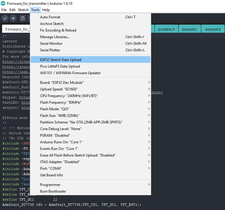

Step 5: Switch the Partition Scheme to the "No OTA (2MB APP/2MB SPIFFS)"
You have to switch the partition scheme to the "No OTA (2MB APP/2MB SPIFFS)" before you continue working with ESP32 because the firmware for the vault is too big for the default partition.
Step 6: Format ESP32'S Built-In Flash Memory
Connect the ESP32 that you're going to use as a core of the vault to the computer. Click Tools -> ESP32 Sketch Data Upload. Then click Yes in the pop-up window. The program is going to format the built-in flash memory.

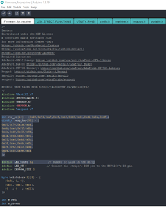

Step 10: Modify the Firmware
Open the firmware from the "Firmware_for_transmitter" and "Firmware_for_receiver" folders.
In the "Firmware_for_transmitter" you need to replace the keys and the receiver's MAC address in the "uint8_t broadcastAddress[] = {0x5C, 0xCF, 0x7F, 0xFD, 0x85, 0x1D}; // Receiver's MAC address" line.
In the "Firmware_for_receiver" you need to replace the keys and the number of LEDs in the strip in the " #define LED_COUNT 32 // Number of LEDs in the strip" line.

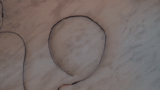

Step 13: Assemble the Transmitter
Assembling the transmitter shouldn't be hard. Just connect the display and the 4x4 keypad to the ESP32, and you're ready to go.

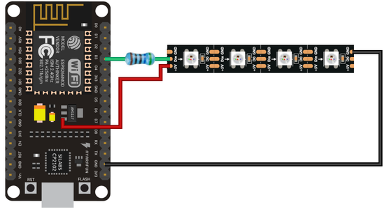

Step 14: Assemble the Receiver
That should be even easier than the transmitter assembly.
Step 15: Power the Receiver Up
Make sure that the power supply can provide enough current for the strip before connecting the assembled receiver to it. You can do it by multiplying the number of LEDs in the strip by 0.06. In my case, it's 0.06 x 32 = 1.92A.
And I would strongly discourage you from supplying the assembled receiver from the USB port because even the USB 3.0 port can barely supply 0.9 Amps.

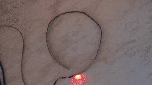

Step 32: Circular Run

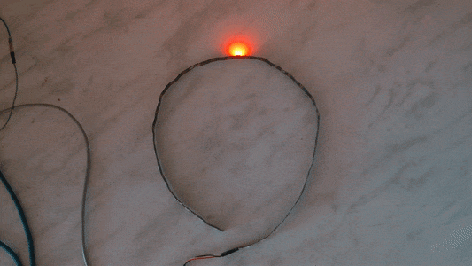

Step 33: Jumping Red

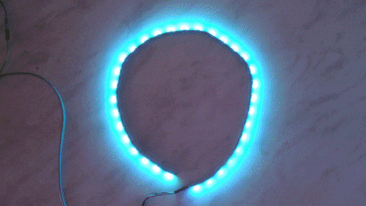

Step 35: Green Ring

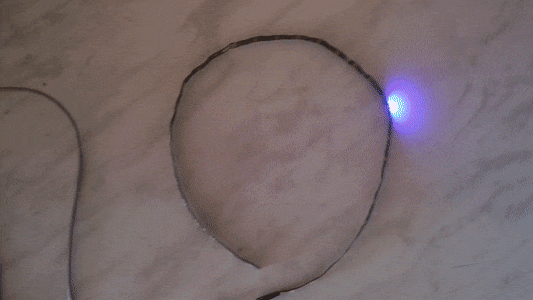

Step 37: Strobing Moon

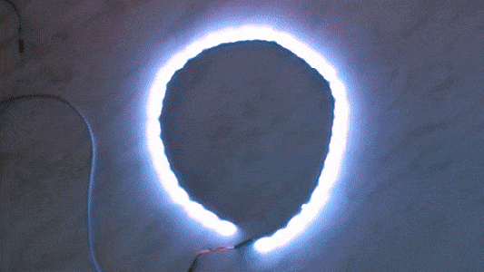

Step 38: Shining Moon
The shining moon mode sets each LED in the strip to the maximum brightness.
I suggest you don't turn it on for long because it may damage the strip.
