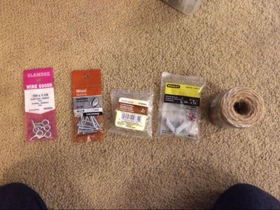

Materials:
  • A 2 ft x 4 ft piece of thin plywood.
  • 6 Eye hooks.
  • 6 Wood Screws (they should be pretty long, I recommend #6 x 1 in screws).
  • 2 little hinges (with screws).
  • 3 corner braces (with screws)
  • Any type of twine that can go through the eye hooks.
  • Big wooden corner brace (OPTIONAL, see step 7)
  • Long 1" x 1" piece of wood (OPTIONAL, see step 7)
  • Drill
  • Dremel
  • An EV3 (Lego Mindstorms) set.
  • A computer with the EV3 software installed.
  • A protractor.

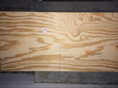

Step 1: Cut the Plywood
Cut the plywood into 4 sections of equal length (1 ft for each section) along the longest side of the wood.
On one of the 4 sections, cut 7 inches from one side of the wood.
You should be left with 5 pieces: 3 are big pieces, 1 is a medium piece, and 1 is a small piece.

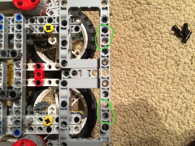

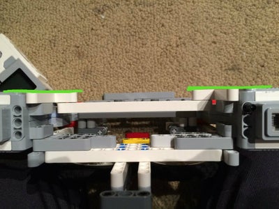

MODIFY LAUNCHER:
Next, there are a few modifications you have to make to allow the launcher to mount to the wood.
  1. Detach middle beam from bottom of launcher (first picture).
    1. Keep that for later.
  2. Take off rubber feet on the bottom of launcher (second picture).

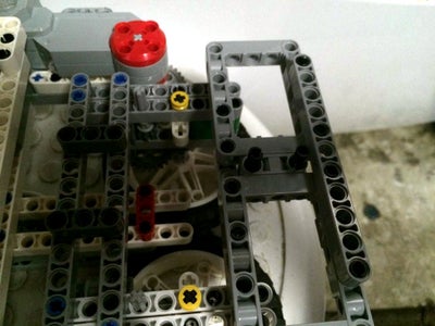

  3. Take off top L-beam from each side of launcher (they are near the motors, 3rd picture will help).
    1. The L-beam part should be flush with the motor (4th picture).
    2. The pictures and annotations on the pictures can help explain what I mean in a little more detail.

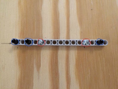

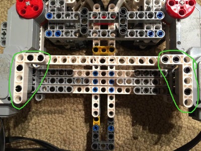

ATTACH LAUNCHER MOUNT:
Lastly, mount that beam from the first modification on the medium sized piece of wood. You need to use the wood screws on the holes circled red in the 5th picture. Also add black lego connectors in the 3 spots circled blue in the 5th picture. For positioning of the mount, the 6th picture can help put the beam into perspective of the wood.

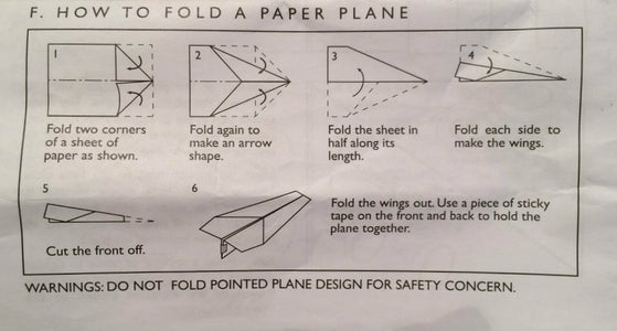

Next, fold the paper airplane. YOU HAVE TO FOLLOW THIS DESIGN EXACTLY OR ELSE THE PLANE WILL NOT FLY!The design is in the 3rd picture (I did not make this design either).
