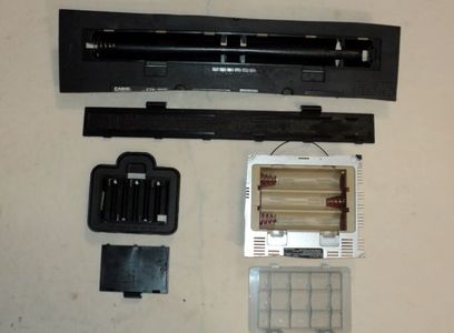

Step 1: The Building Blocks
I like to save battery compartments that are well made, they offer excellent housings for a variety of cell sizes: AAA, AA, C, and D. Cutting them out of discarded devices is not too difficult, and getting them ready for service requires a minimum of time.

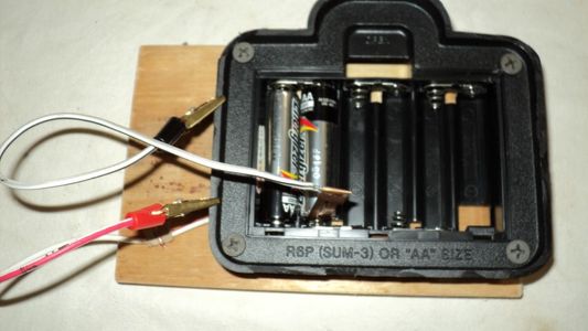

Step 2: The Voltage Tap
A cutout section of some saved phosphor- bronze grounding fingers will suffice quite well for the voltage selector tap. Use what you have at hand however, later it can be upgraded if needed

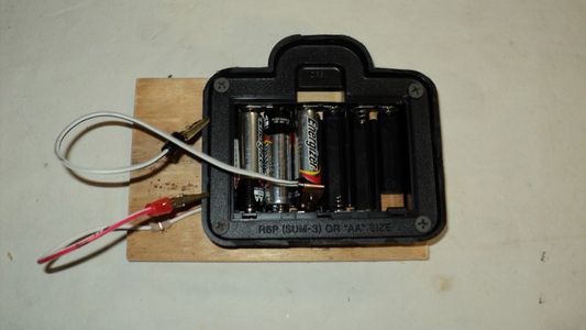

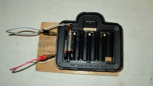

Step 3: Ease of Use
Selecting the desired voltage is as simple as placing the tap finger behind the appropriate cell and contact as the images show. 1.5, 3.0, 4.5, and 6.0 volts, all the way up to 9.0 with this particular build is possible.
