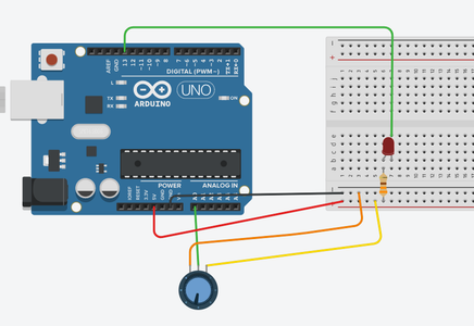

I made an Arduino circuit in my Mech 1 class. The Arduino is connected to the breadboard and a potentiometer. the potentiometer can change how fast the led will "blink."
1x Arduino Uno
1x Laptop with Arduino IDE
1x USB A to USB B cable
6x Wires
1x POTENTIOMETER
1x LED
1x 330 ohm resistor
Step 1: Wiring Arduino
get all your supplies, then use three wires connect the potentiometer output to A0 on the arduino board. Connect another wire from the voltage pinout to negative rail on the breadboard. Connect another wire from the ground pinout to positive rail on the breadboard.
On the arduino board, connect 5V on analog in to positive rail on the breadboard and GND to negative rail on breadboard.
Next, connect your resistor from the negative rail to the main circuit area. Then, have an LED (anode side) connect to the resistor and have the cathode side wire to pinout 13 on the arduino's digital side.

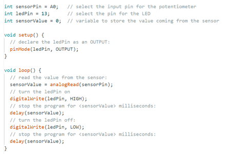

Example code of AnalogInput, making the LED blink faster or slower depending on the potentiometer which is the sensorValue.
Step 3: Arduino IDE
Use the Arduino IDE and put in the code shown above. You will need to connect your USB A to USB B cable into the Arduino Uno board.
