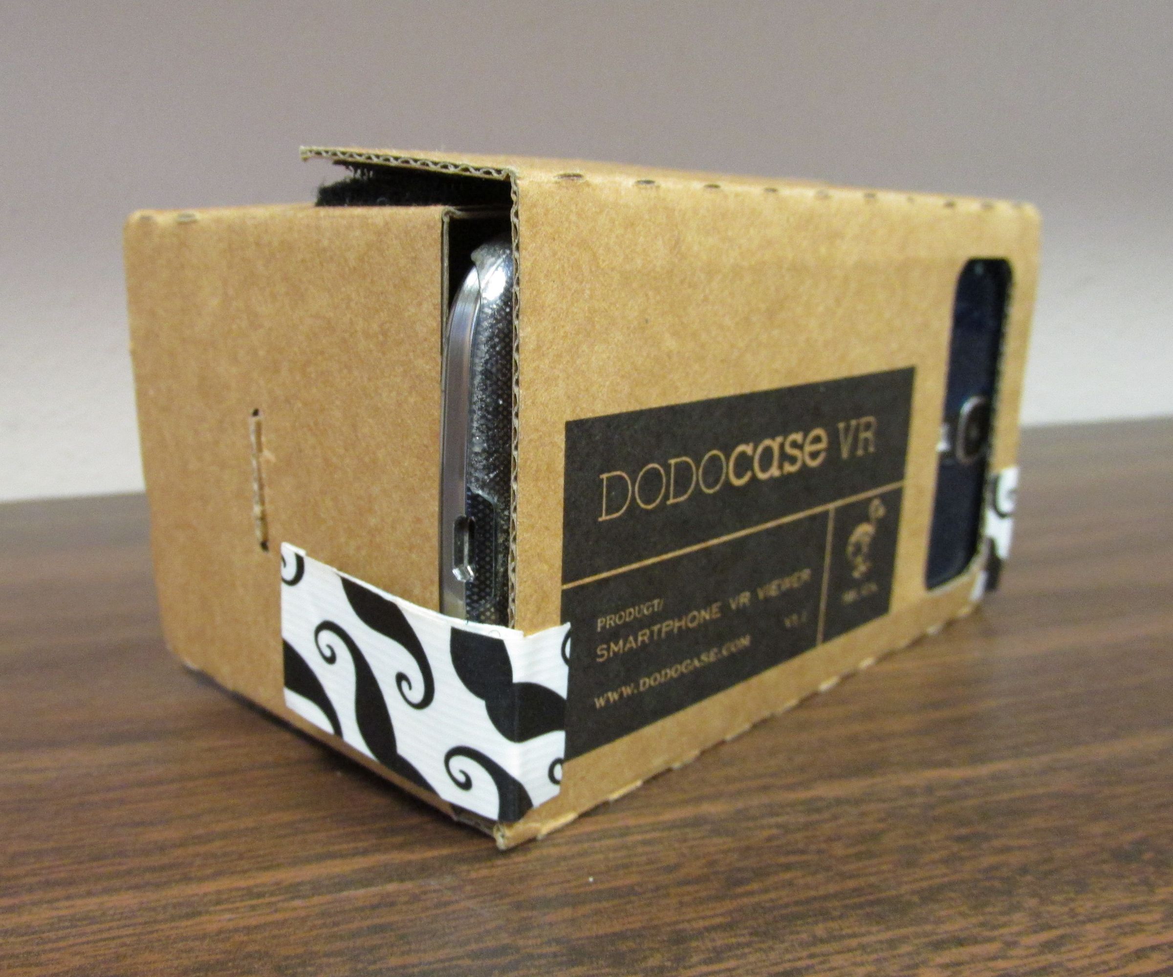

Introduction: Adjustable Head Strap for DoDo Case Build Night
Thought that a head strap might be a nice touch for the DoDo Case Virtual Reality Viewer. I used some velcro straps to make sure you could adjust it to different head sizes.
