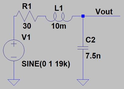

The circuit is built around the properties of a series LC circuit. The circuit presents a resonant frequency at f= 1/(2*pi*√L̅C̅). At this frequency, the impedance of the circuit presents a minimum, and thus the current through the elements is maximum. More interestingly, the inductor and the capacitor exchange their energy at this frequency in a perfect manner, the sum of the stored energies in both elements is constant in time, and equal to 1/2LI^2 and to 1/2CVc^2. Therefore, if the series resistor is small, the intensity will be high, and so will be the stored energy in both elements. As the energy at the capacitor increases with the square of its voltage, if the stored energy is high, its voltage will also be high.
So at the resonant frequency, and with a small series resistor, we will get a higher voltage at the capacitor (and inductor, as their voltage is equal but opposite) than the input voltage (both sinusoid waves). This will happen if the series resistor is less than √L̅/̅C̅. Specifically, the voltage gain will be √L̅/̅C̅/R.
The proposed circuit uses a high value inductor and a small value capacitor, in order to maximize the voltage gain. With a 30 ohm series resistor (which includes the resistance of the inductor and the output impedance of the source), a voltage gain of 31 dB is achieved at the resonant frequency of 18.4 KHz. The frequency range in which there is voltage gain is small if the series resistor is small, as can be seen in the Bode plot above. By changing the input frequency around the resonant frequency, we will get a varying output voltage.
Instead of a sinusoid wave as input to the resonant LC circuit, a square wave can also be used. The voltage at the capacitor will still be a sinusoid, due to the strong filtering action. This is the principle used in the proposed circuit: a square wave is generated by a NE555 in astable oscillator configuration (50% duty cicle). This is the orange cable seen in the photo of the circuit. A trimmer allows for a variable output frequency, which in turn produces a varying sinusoid voltage at the capacitor as we separate from the resonant frequency.
