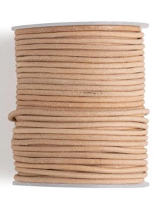

  1. A cord. I am using a 2mm leather cord. I have seen instructions for 1.5mm cords, 2mm satin cords, and leather lacing; so it is really up to you want you want to use. Just make sure it will allow the knots to slide (no chains, twine, etc.).

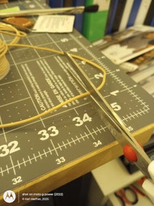

Step 3: Measure and Cut the Cord
Measure the cord to the length you calculated and cut it at that point.

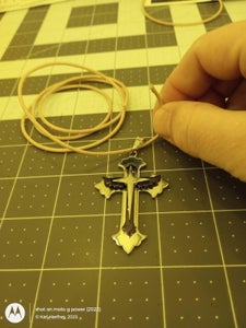

Step 4: Attach the Charm
If your necklace is going to have a charm with a bail, run the cord through the bail. Otherwise, skip this step.

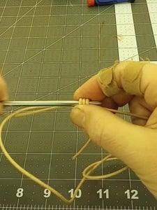

Step 5: Hold the Screwdriver
Pick up the screwdriver.
Step 6: Measure and Place
Measure out 4½" of cord. Pinch the cord with your finger and thumb to keep it in place. Bring your "pinch" up to the barrel of the screwdriver.

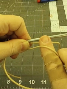

Step 7: Make a Loop
Bring around the other end of the cord so as to make a loop. You should now have a parallel arrangement of three items: Top is the screwdriver, middle is the loose end, bottom is the loop. From this point on, those are the terms I will use for each of the three levels, respectively.
Step 8: Bring the Loose End Down
With your index finger, reach behind the loop to take hold of the loose end. Bring the loose end down behind the loop.

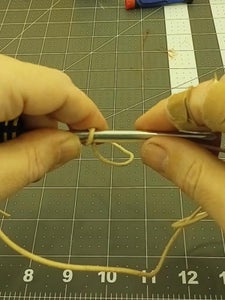

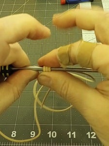

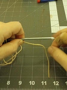

Step 9: Create the Barrel
Bring the loose end in front of everything. Wrap it around the screwdriver. Make sure that it includes the loop. Wrap the loose end around everything two more times, ending with the loose end hanging down, as in the picture.

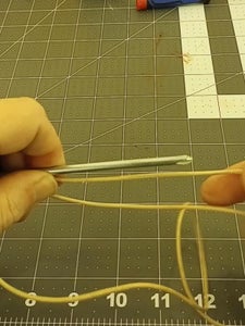

Step 10: Remove the Screwdriver
Take hold of the wrapped barrel using your hand opposite the side the screwdriver handle is on. Keeping a little pressure (but not crushing) on the barrel, slide the screwdriver out.

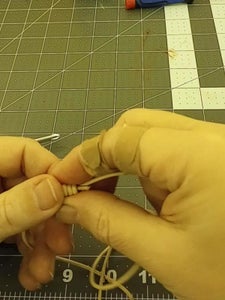

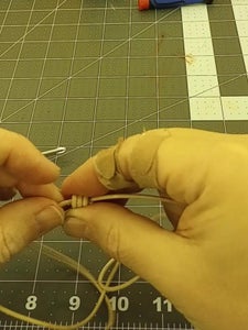

Step 11: Thread the Barrel
Thread the loose end (NOT the other end of the cord but the loose end you've been using to create the barrel) through the middle of the barrel. I know it is hard to see in the picture, but the loose end is now poking out of the other end of the barrel.

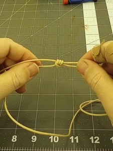

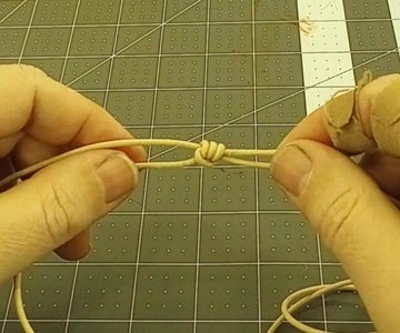

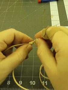

Step 12: Tighten the Knot
Grabbing the loose end on one side of the knot and the loop (NOT the other end of the cord), pull both cords to tighten the knot. As you can see in the pictures, the barrel may need a little bit of coaxing to make sure the wraps stay together.
Step 13: Do the Other End
You have completed your first knot. Using the other loose end of the cord, repeat steps 5 through 12 to make the second knot.
Step 14: Conclusion
You now have an adjustable-length cord necklace. If you make it shorter, it could also be an adjustable-length cord bracelet. The next thing I need to do is figure out how to keep the leather cord from coiling up, like it's still on the spool. Figured it out!
