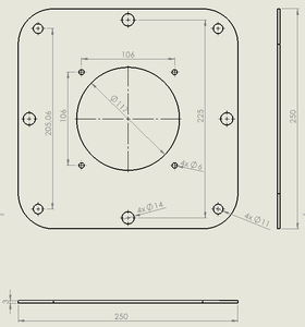

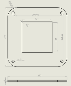

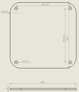

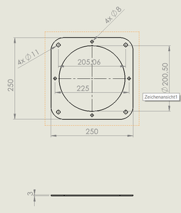

Cut the wood panels according to the drawings/.step files.
Cut the 1m threaded rod into four equally long pieces (250mm each).
Glue the 6mm wood panel with the square in the middle on top of the 3mm wood panel with the 117mm hole in the middle.
Glue the 6mm wood panel without the square to the 3mm wood panel with the 200.5mm hole in the middle.
