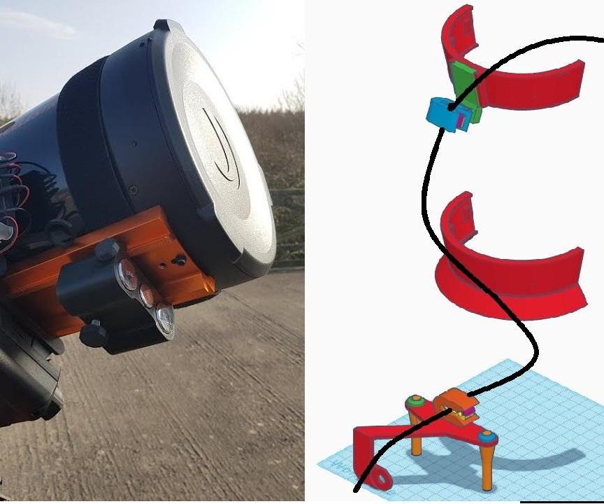

As I'm doing an astrophotography session I often change the equipment on the back of the 'scope, so I'll have various combintions of camera, off-axis guider, Barlow lense or a focal reducer, each of which will cause the balance point in the 'scope's declination to change.
In order to make the mount's job as easy as possible I designed this conterweight system that will allow you to balance the 'scope on the mount with your lightest equipment attatched, then when you add heavier equipment to the scope you can move the counterwieght and / or change the weight in the holder to get back your perfect declination balance.

Now, get your three 19mm x 9mm springs and bend the very top coil of each of them up using some needle-nosed pliers so that it looks like it does in the photograph. This allows the spring to engage in a threaded hole at the bottom of the counterwight body. Use a pair of needle-nosed pliers to position each spring (opened up end pointing towards the threaded hole) against its retaining threaded hole, then screw it in until it is firmly in place.

At the start of your astrophotography session, add the lightest set of equipment you expect to use to your telescope, as well as all cabling, etc., and then balance it in declination and right ascension (Dec and RA) as you would normally.
When you change the equipment on your 'scope, adding more weight to the back of the 'scope, slide the counterweight onto the dovetail at the front of the 'scope and then add enough weight at the appropriate point on the dovetail for the declination axis in order to get your declination balance correct again, then tighten the M8 Knob to secure the counterweight in place.
The next time you change equipment, add or remove weights, and / or reposition the counterweight, to keep your Dec balance correct with the new equipment.
If there are no weights in the counterweight body, just unscrew and remove the M4 bolt, slide whichever weights you think are required into their appropriately sized slots, then push them down against their springs and slide the M4 bolt back into place, then screw it home. The springs stop the weights from moving as the mount moves the 'scope to point to different points in the sky!
