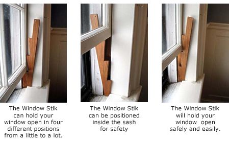

3. Buy a cool prop stick from the Window Woman of New England:
http://window-woman-ne.com/window-stik.html
I bet this is like the best window stick thing that $18 can buy.

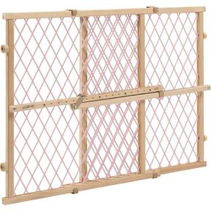

We have a wooden baby gate that used to keep our kids in but currently keeps our ducks out (they're always trying to weasel into the house to steal cat food). It stays in place using a little swinging bar and some notches and leverage and such, and I think that's pretty cool. So this prop rod also stays in place using a little swinging bar and some notches and leverage and such.

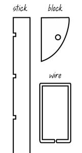

I drew some pictures in Adobe Illustrator and managed to plan it all out pretty well before I fired up any power tools (a PDF of that doodling is attached to the last step of this 'ible). The relative dimensions are more important than the actual dimensions, but in the interest of completeness I'll be providing some measurements.

Cut the wedge-shaped block out with your jigsaw. The straight sides of mine are 2" and 2-1/4", for no particular reason.
Drill a hole in the block about halfway down the curved side, and about a quarter inch in. Use a drill for the drilling, because that's what drills are for.
Cut your stick to whatever length makes sense for your desired window-propping range; I went with sixteen inches for no particular reason.
Notch the stick. I put the notches closer together toward the bottom, then farther apart toward the top. Place the lowest notch only a couple inches from the bottom, because you can't go any lower than the height of the block. The notches need to be deep enough to keep the wire in place, and wide enough to allow the wire to slip in and out easily; 1/8" was plenty for me.

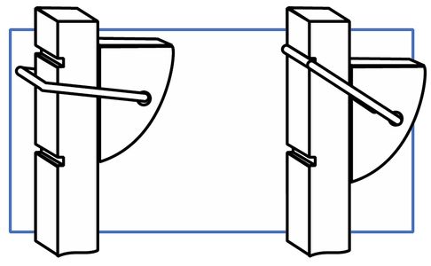

The wire is bent into a rectangle whose ends terminate inside the block.
Figure out how long your wire needs to be:
  • The length of the first bend should be a little less than half the thickness of the block; 3/8" or so.
  • Hold the block against the stick. The second bend is a little more than the distance between the hole in the block and the edge of the stick, or about 2-1/4".
  • The third bend is a little longer than the full thickness of the block, or about 1".
  • The fourth bend is the same length as the second bend (2-1/4"), and
  • The fifth bend is the same as the first (3/8").
Add that up and cut your wire as long as it needs to be; it will be in the ballpark of six inches.
Make all the bends using pliers or your teeth, leaving the ends bent outward a bit. Then place one end into the block and bend so that each angle is 90 degrees, the ends are both plugged into the block, and the arm swings around easily.

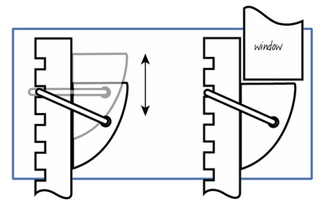

Slide the block onto the stick, with one flat side facing up, and the curved side facing away from the stick.
Check all the notches to make sure the wire drops in easily and the block slides up and down.
Make a safety line. Mine was made from some clothesline stuck through a hole near the base, but you are welcome to make yours out of 14 carat gold or licorice.
Step 6: Prop That Window, and Revel in Your Accomplishment.
Slide the block to the desired height, drop the wire into a notch, and rest your window on the prop.
