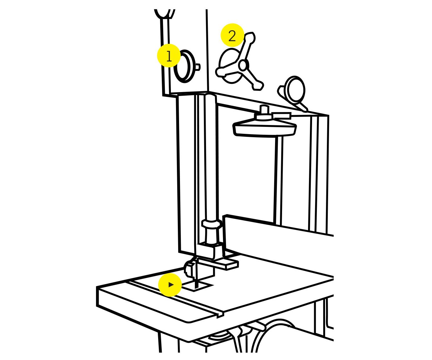

Adjusting the Blade Guard and Guides
The blade guard helps to prevent contact with the exposed blade. Use it every time.
- Loosen the lock knob.
- Turn the handwheel to raise or lower the guard and guides.
- The blade guide should be 1/4" above the material being cut.
- Snug the lock knob.
