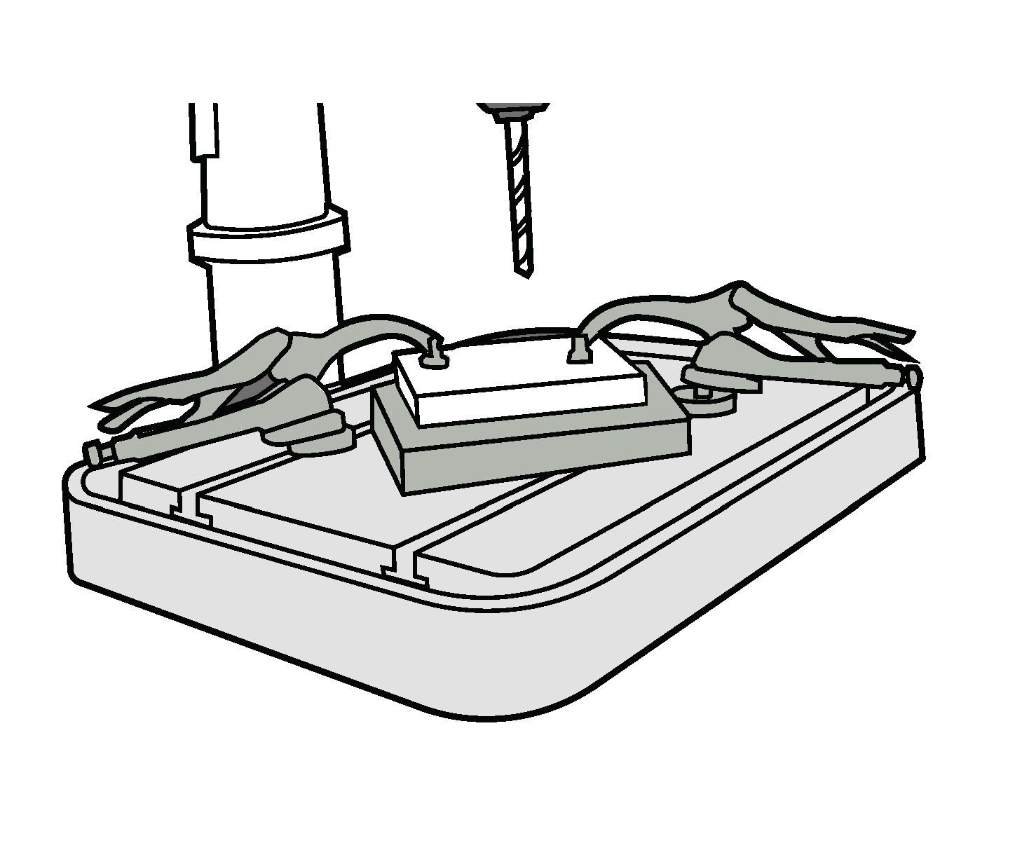

Step 1: Using Clamps
Properly position the work before operating the drill press.
Always clamp the workpiece. The drill bit can grab, and cause the material to spin dangerously.
There are a variety of clamping options available; ask Shop Staff if you need assistance.
Note: Do not drill into the table. If you are going to drill through the workpiece, put a sacrificial board or piece of metal under the workpiece

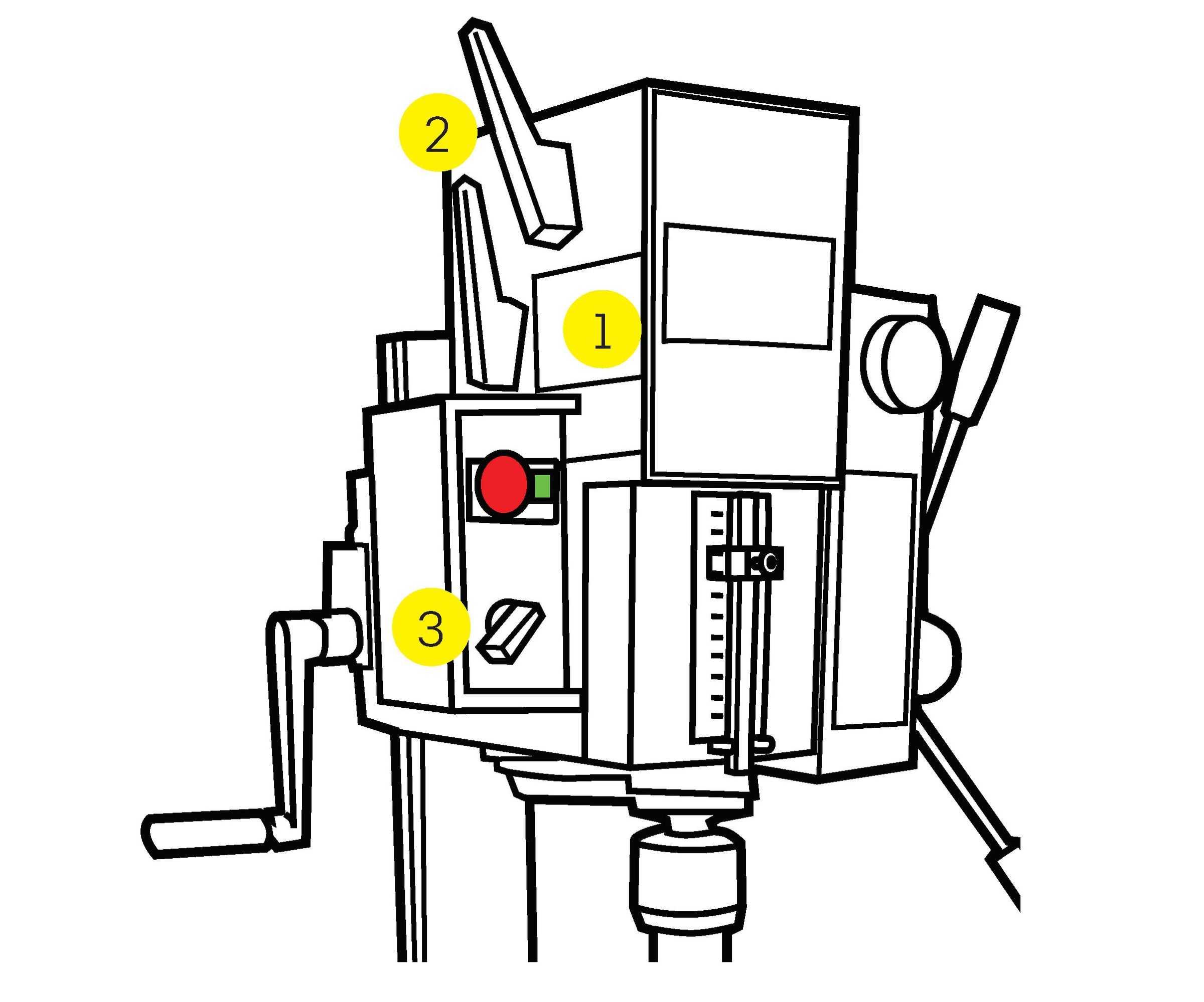

Step 2: Changing Speeds
All speed changes must happen with the motor off.
- Use the speed chart to determine settings.
- Move the upper & lower levers to match the image on the chart.
- If a lever is difficult to engage, rotate the chuck by hand while moving the lever.
- When you are ready to start the motor, rotate the speed selector to 1 or 2, according to the speed chart.
- Always turn the knob to the right (clockwise), so the motor spins the correct direction.

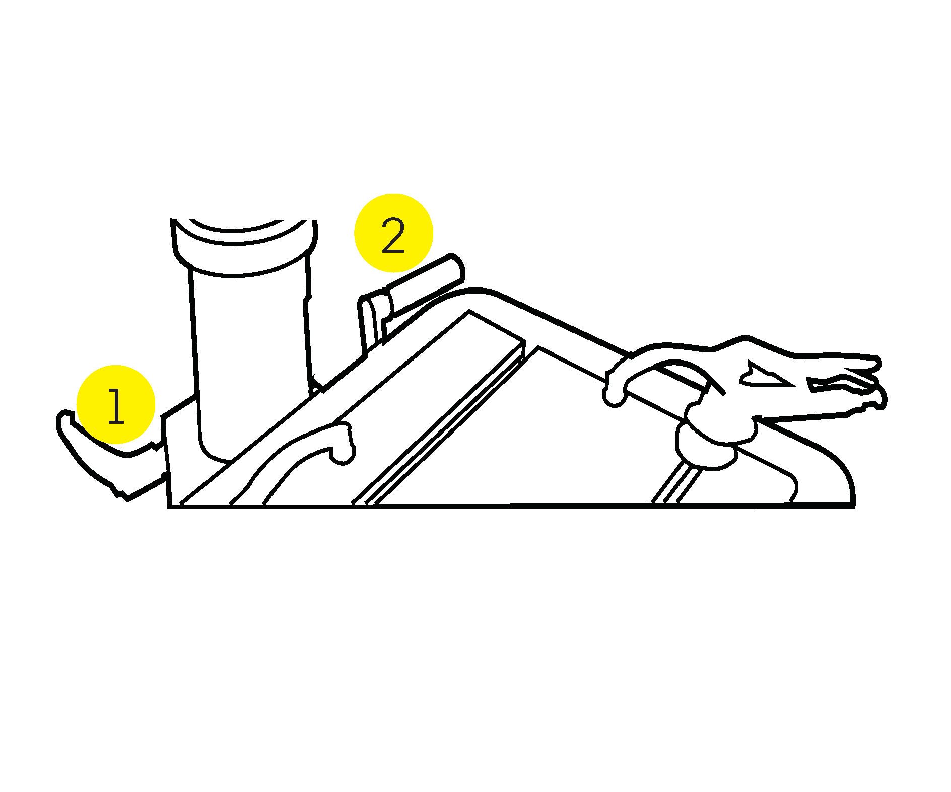

Step 3: Adjusting the Table Height
All adjustments must happen with the motor off.
- Move the lever to unlock the table.
- Rotate the handle to raise or lower the table.
- The table can be rotated around the column when unlocked.
- Lock the table.
