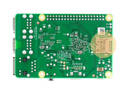

Step 1: Enter MicroSD Card to Raspberry Pi
To get started, simply insert your SD card into the SD card slot on your Raspberry Pi or Orange Pi.
Since the card is already pre-configured, you’re all set—it’s already flashed with the AdoPisoft software image, so there’s no need for extra setup.
Just plug it in, and you're good to go!

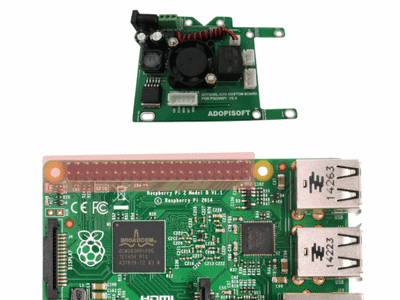

Step 2: Attach the Stand and Heatsink
Now, let’s give your Raspberry Pi or Orange Pi some stability and cooling.
Start by attaching the stand that comes with your custom board. This will keep everything secure and in place.
After that, take the heatsink and carefully place it above the processor.
This is going to help regulate the temperature and keep your system running smoothly without overheating.
Step 3: Insert Custom Board Female Pin Headers Into RPi/OPi Male Pin Headers
Next up, grab your male pin headers for the Raspberry Pi or Orange Pi and carefully insert them into the female pin headers on the custom board.
This is where things start to really come together.
Just a heads up, if you’re using this custom board for the Raspberry Pi, you might need to trim the tip of the board to ensure a perfect fit.
It’s a simple step, but it’ll make all the difference in getting everything aligned properly.

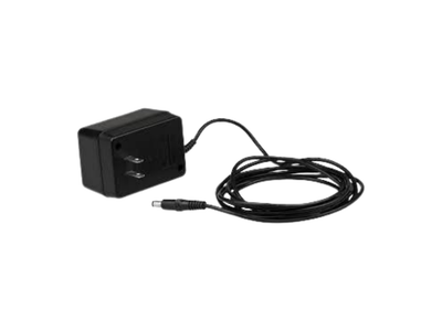

Step 7: Plug in Custom Board and Newifi Power Adapter
Now it’s time to power everything up!
Plug in both the custom board power adapter and the Newifi power adapter.
You’ll know that your Raspberry Pi or Orange Pi has successfully booted when you see the green light indicator pop up.
Also, keep an eye on the Newifi device—there should be a blue light above the power icon, as well as above the 2.4G and 5G indicators.
Once those lights are glowing, you're in business!
