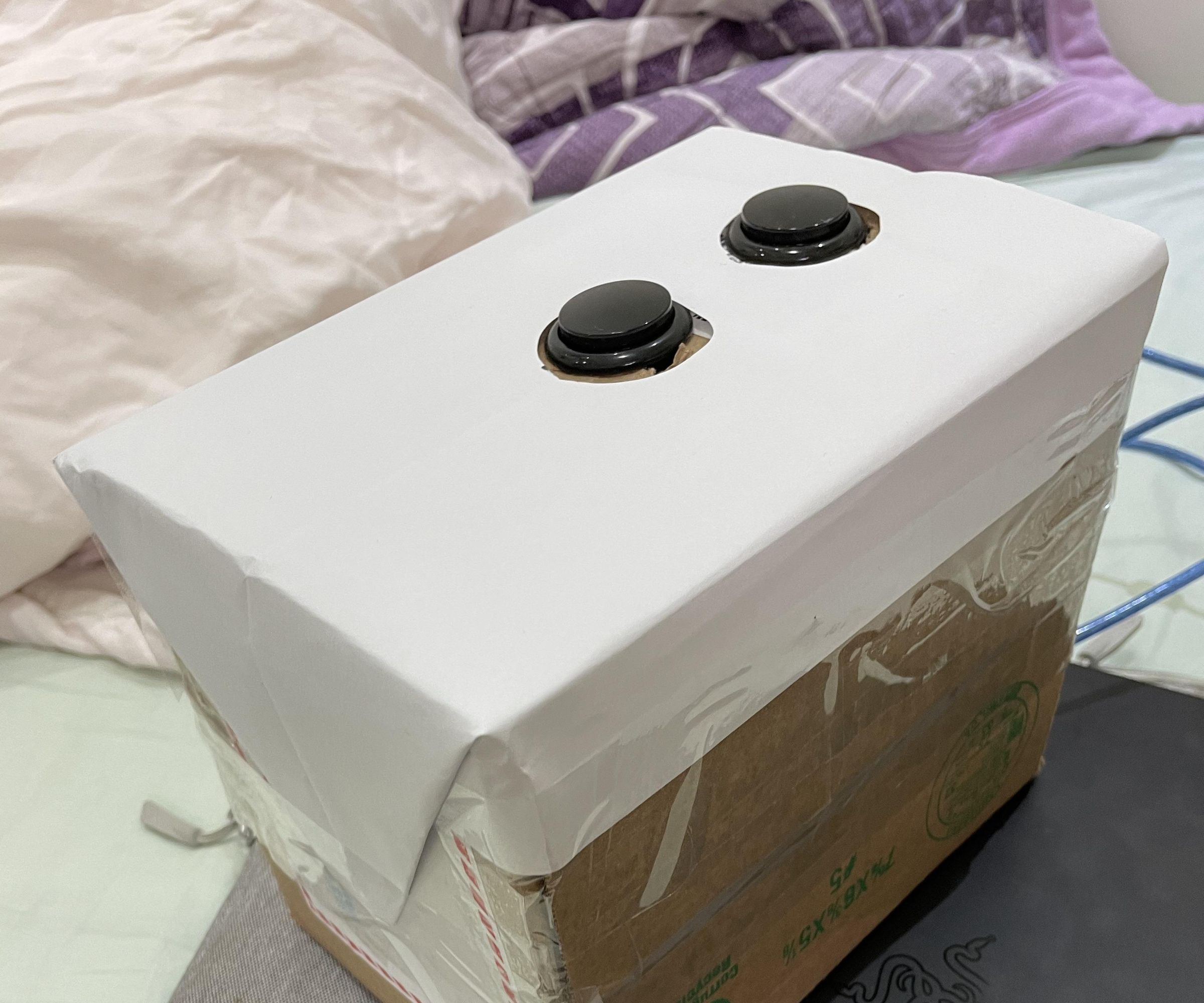

Step 2: Make the Container of the Breadboard
Take a cardboard and make three length 3.2 cm and weight 3.2 circle hole on the top of the box. After that, put three buttons in the to holes. After that, make another 3cm x 2cm square hole at the side of the box for the cable. Remember to pick a shorter cardboard, so the line length of the jumper wires can be shorter.

Step 6: Final Result
The Shortcut Key machine is useless that allowed the editor to create a better machine, so they can edit a great video easier.
