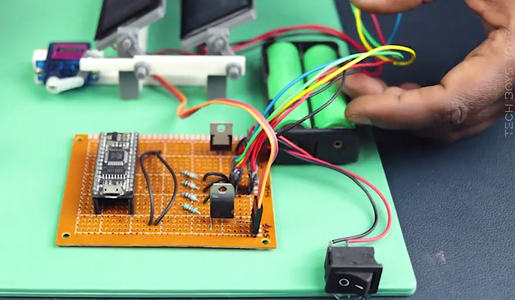

This is done to simplify the wiring system in our project as I have made a PCB for this circuit.
Now connect these pin directly to the circuit we made.

After these we can add Arduino to our main PCB board.

After you upload the code to board add lithium ion battery pack with switch control to the main circuit.
