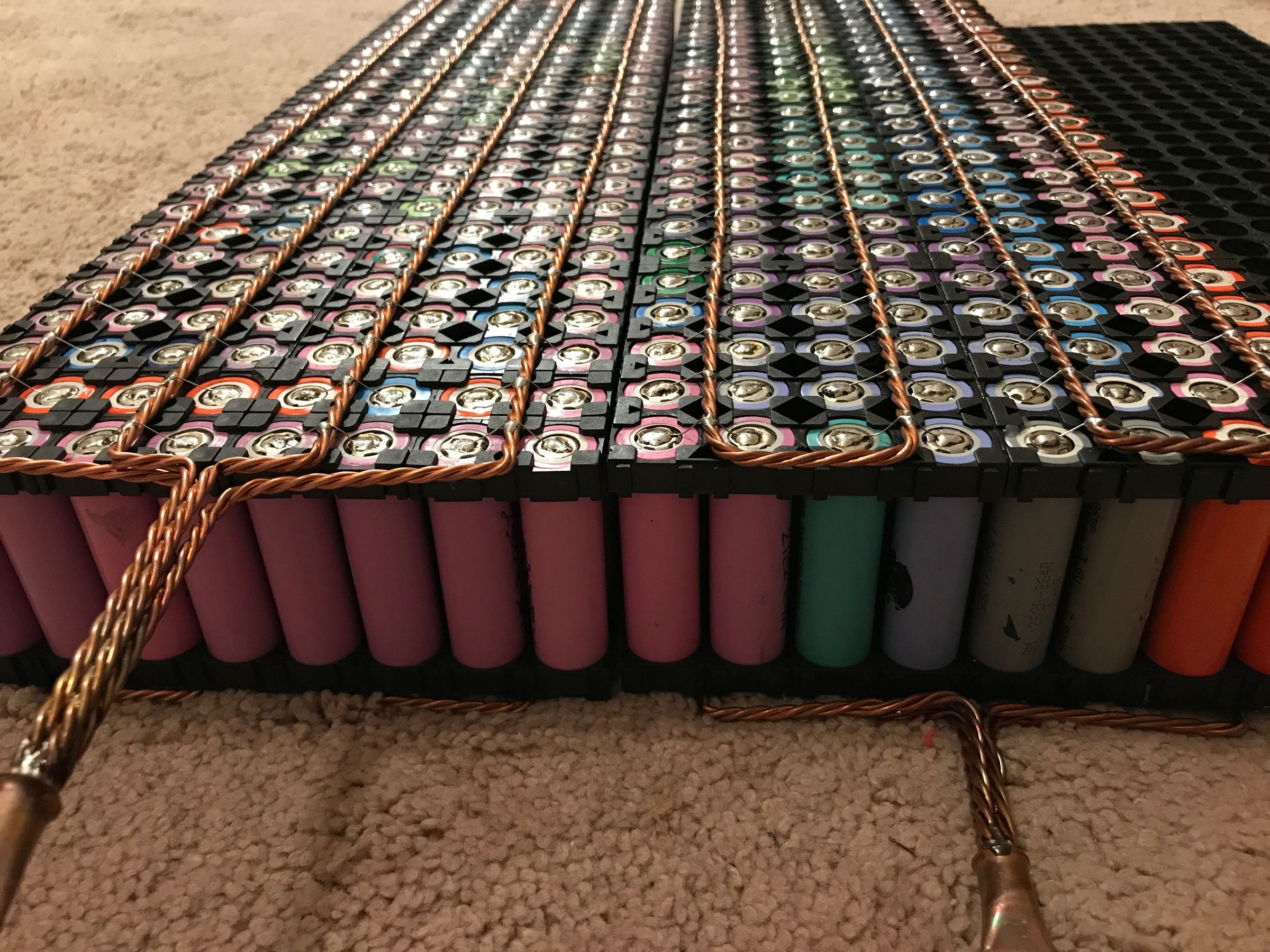

I am modifying this project, both hardware and software, with a goal of making it stable at 300W/ 10A. This is just the beginning of what will surely become an excellent DIY Battery Tester/ General Purpose DC Load. A comparable unit from a commercial vendor would cost you hundreds, if not thousands, of dollars so if you are serious about testing you DIY 18650 Powerwalls for maximum safety and performance, I highly encourage you to build this for yourself.
