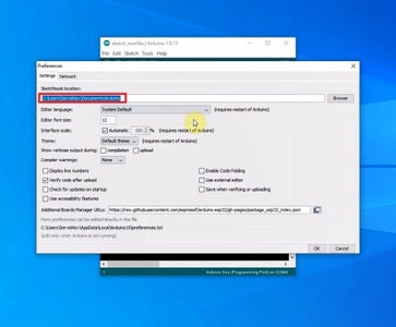

 1. In your Arduino IDE, go to File> Preferences
 2. Enter the following into the “Additional Board Manager URLs” field:
https://raw.githubusercontent.com/espressif/arduino-esp32/gh-pages/package_esp32_index.json
 Then, click the “OK” button:

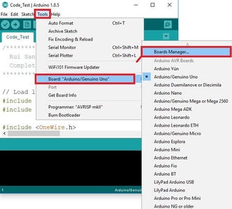

3. Open the Boards Manager. Go to Tools > Board > Boards Manager…
 4. Search for ESP32 and press install button for the “ESP32 by Espressif Systems“. Just to mention that in my case I used arduino core for ESP32 ver.2.0.4 :
5. That’s it. It should be installed after a few seconds.

2. Find your Sketchbook location. In your Arduino IDE, go to File > Preferences and check your Sketchbook location.

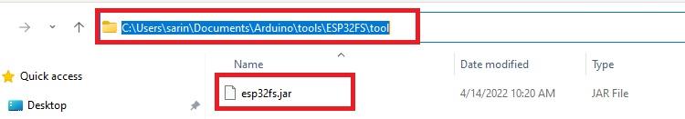

3. Go to the sketchbook location, and create a tools folder.
4. Unzip the downloaded .zip folder. Open it and copy the ESP32FS folder to the tools folder you created in the previous step.
5. Finally, restart your Arduino IDE.
To check if the plugin was successfully installed, open your Arduino IDE. Select your ESP32 board, go to Tools and check that you have the option “ESP32 Sketch Data Upload“.

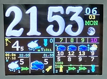

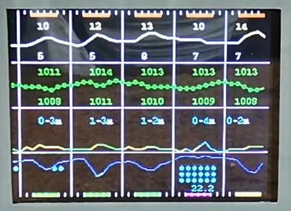

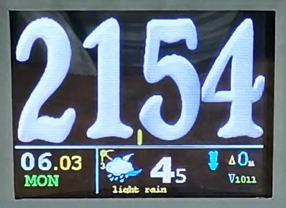

 On the main screen you can see basic informations. It contains a medium-sized clock, date, current weather with UV index, wind speed and direction and air pressure, sunrise and sunset time, forecast for the next 3 and 6 hours, as well as for the next four days. Really a lot of useful weather information on one screen.
Step 6: All Screens

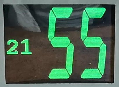

  By touching the metal plate on top of the device, we move through several screens containing different weather information. Below you can see screenshots of these screens:

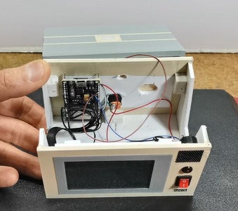

  The device is installed in a suitable box made of PVC material with a thickness of 5 mm and covered with self-adhesive colored wallpaper.

 The code also contains a mini analog clock and internet radio. This menu is accessed by a long click from any previous condition. In order to enter Internet stations according to our own desire, we need to modify the text file "i_stat" which is located in the "meteo" folder. The digitasl audio signal is generated on pins 25 and 26 and we need to use audio decoder chip and small audio amplifier. For example MAX98357 audio decoder with amplifier board cost less than a dollar. Also, with a small modification of the code, high-ohm headphones can be connected directly to the microcontroller.
