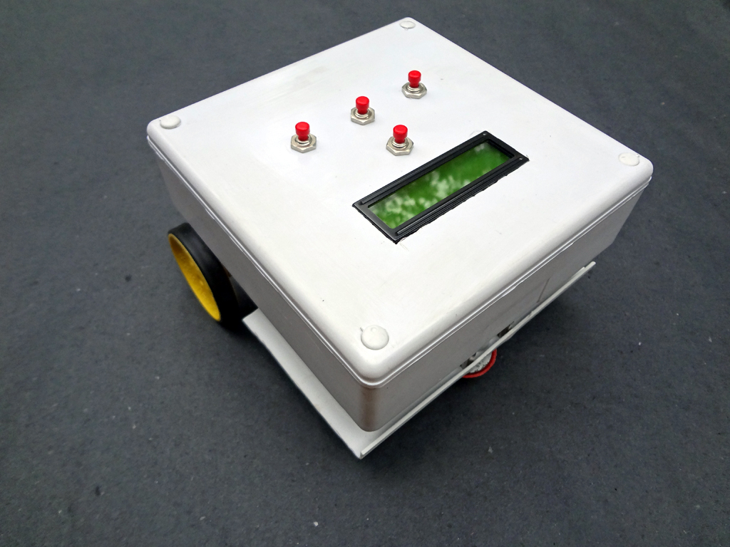

Introduction: Advanced Line Following Robot
This is an advanced line following robot based on Teensy 3.6 and QTRX line sensor that I have built and have been working on for quite some time. There are some major improvements in the design and performance from my earlier line following robot. The speed and response of the robot has improved. The overall structure is compact and lightweight. The components are arranged close to the wheel axis so as to minimize angular momentum. High power micro metal gear motors provide the adequate torque and aluminium hub silicone wheels offer much-needed traction at high speeds. Prop shield and wheel encoders enable the robot to determine its position and orientation. With Teensyview mounted on board, all the relevant information can be visualized and important program parameters can be updated using pushbuttons.
To begin building this robot, you will need the following supplies (and a lot of time and patience at your disposal).

Step 1: Systems Overview
As with my earlier design of a self-balancing robot, this robot is an assemblage of breakout boards mounted on a perfboard which also serves the purpose of a structure.
The major systems of the robot are outlined below.
Microcontroller : Teensy 3.6 development board featuring 32-bit 180MHz ARM Cortex-M4 processor.
Line sensor : Pololu's QTRX-MD-16A 16-channel analog output line sensor array in medium-density arrangement (8mm sensor pitch).
Drive : 6V, 1580rpm, high power micro metal gear motors with magnetic wheel encoder and silicone wheels fitted on aluminium hubs.
Odometry : Magnetic wheel encoder pairs for estimating the coordinates and distance covered.
Orientation sensor : Prop shield with motion sensors for estimating position and heading of the robot.
Power supply : 3.7V, 750mAh lipo battery as power source. 3.3V step-up/down regulator powers microcontroller, sensors, and display device. Adjustable step-up regulator powers the two motors.
User interface : Teensyview for displaying information. Three-pushbutton breakout for accepting user inputs. Two numbers of 10mm diameter green LEDs for status indication while running.

Step 21: Test Run
The video is of a test run in which the robot is programmed to stop after it completes one lap.
Step 22: Final Thoughts and Improvements
The hardware which is put together to build this robot is not utilized to the full by the program which runs it. Lot of improvements could be made on the program part. The motion sensors of prop shield is not used at present for determining position and orientation. The odometry data from encoders can be combined with the orientation data from prop shield to accurately determine the position and heading of the robot. This data may then be used to program the robot to learn the track in multiple laps. I encourage you to experiment on this part and share your results.
Good luck.
