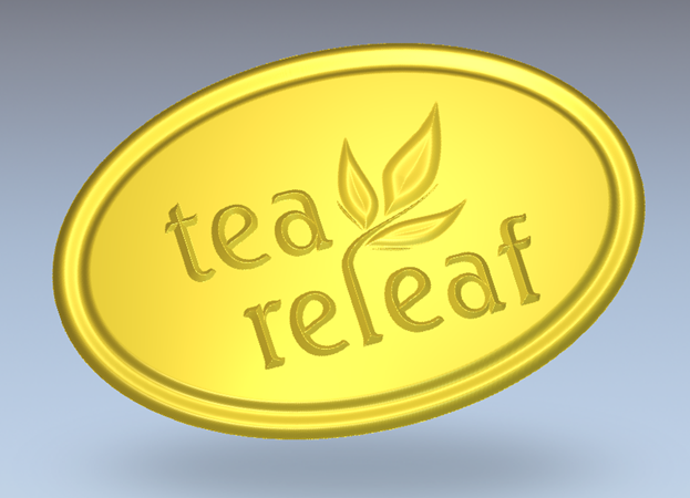

Step 1: Tea Releaf Tutorial
- Open Tea Releaf.art
- Shape Editor - text Tea Releaf - Round Shape – 45º
- Reset the created relief
- Contour Blend
- text Tea Releaf
- Side Profile – Linear – 45º
- Check Preserve Interior corners
- Contour Blend
– large middle leaf
- Selected Vector – select wavy cross-section – click Set Profile Vector
- Override Width = 0.625” (15mm)
- Select smaller top and bottom leaves
- Override height = 0.2” (2mm)
- Override Width = 0.5” (12.5mm)
- Shape Editor
- all leaves, Add
- Flat Sape – 0.02” (0.5mm)
- Smooth Relief – 20%
- Vector Layer = Outside , Relief Layer – elliptical sign base
- Contour Blend – Outside vector
- Set Profile Vector – wavy cross-section
- uncheck both Override height and width

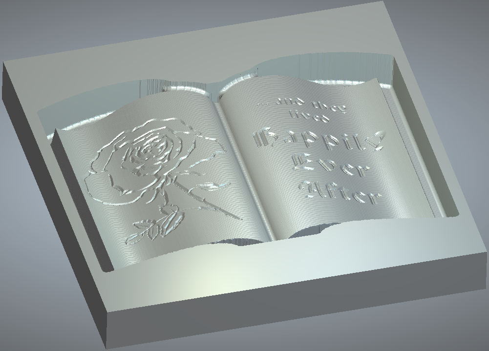

Step 2: Feature Machining Book
Create a clean 2D-style engraved toolpath over a 3D relief surface.
- Create a New Model 300mm x 250mm (12” x 10”)
- Origin in the lower left corner
- Open the Relief Clipart Library , import Book, from
the Objects section
- Width = 275mm (11”)
- F9 to center
- Z = 20mm (0.75”)
- Check Paste Outline Vector
- Paste
- Import Vectors – Rose1.eps
- Manually center on left page
- Text Tool
- Text = Arthur
- Size = 17mm (0.5”)
- Justification = centered
- Type the following:
- and they
- lived
- Size = 25mm (1”)
- Happily
- Ever After
- Feature Machining Toolpath - rose
- Recessed
- Depth = 1.25mm (0.05”)
- Check corner sharpening for top and bottom
- Tool = V-Bit 32mm 90 degree (V-Bit 1.25 Inch 90º)
Rotate model to view form side, see toolpath following relief, always 0.05” into the relief.
- Feature Machining Toolpath - text
- Recessed
- Area Clear
- Machine Relief Toolpath
- Selected Vector – book outline
- Tool = 6mm ball nose (1/4 Inch ball nose)
- Simulate All

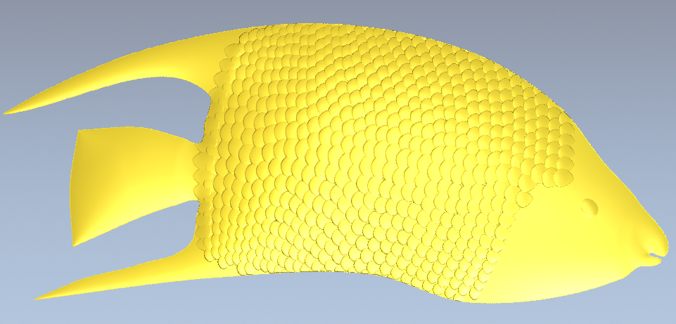

Step 3: Texture Flow Fish
- Open Model Fish Scales.art
- Texture Relief
- Selected Vector, Size = 0.5 and Z Height = 0.1
- Select green boundary vector and click Add
- Reset Relief
- Texture Flow tool
- Set Object = blue scale clipart
- Set Flow Vector = red ‘Flow Vector’ vector on the fish
- Select Reset in the Presets section
- Select Mirror Along
- Select Keep
- Select the pre-existing boundary of the fish body
- Click Calculate
- Reset Relief
- In the Along Flow Vector section, input the values of 75 to 90% of width.
- In the Away from Flow Vector, insert the values of 50 to 50% of height.
- Re-select the texture boundary and click Calculate.
- Reset Relief
- In the Along Flow
Vector section, check the Vary Scale
box
- Start Point = 90%
- Position 2 = 150%
- End Point = 65%
- Click Set Position 2 and then click in the middle of the red flow vector near upper part of the tail
- Randomise Object, input the Scale values of 100 to 110% as the scaling limits.
- Angle variance of 10 degrees.
- Select the large vector representing the entire fish Zero Outside Vector

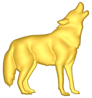

Step 4: Sculpting a Wolf Tutorial
- Open Wolf.art
- Reset Relief
- Duplicate Original Vector Layer
- Rename copied layer = My Wolf
- Edit vectors
- Smooth sharp edges
- Extend to cover body parts
- Discuss design
- Overlapping vectors (blend)
- Spaces between shapes (definition)
- Shape Editor – entire wolf
- Outline – Add & Apply
- Far legs - Merge high & Apply
- Close legs - Merge high & Apply
- Tail - Merge high & Apply
- Stomach - Merge high & Apply
- Neck - Merge high & Apply
- Head - Merge high & Apply
- Ear – Add & Apply
- Inner ear – Add & Apply
- Eye – Add & Apply
- Greyscale
- Primary colour = yellow
- Sculpting Step 1 – smooth edges
- Smooth
- Radius=30, Strength=25%, Smoothness=100%
- Excluding Colour yellow
- Drag mouse around every raised vector edge once
- Snapshot
- Sculpting Step 2– raise area’s
- Smooth
- Radius=30, Strength=50%, Smoothness=100%
- Combine mode = Raise Only
- The darker lines (blue) require much more sculpting, pass over them with the sculpting tool several times
- The lighter lines (pink) only need two or three passes
- Snapshot
- Sculpting Step3 – re-smooth and blend
- Smooth
- Combine mode=Normal
- Snapshot
