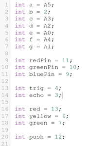

Step 3: Breaking Down the Code - Declare Variable Names and Pins
This is the easy part of the code. Declare each variable for each component and which Arduino pin they use like so. You can use whichever variable name you'd like, or simply just use the same one's provided.

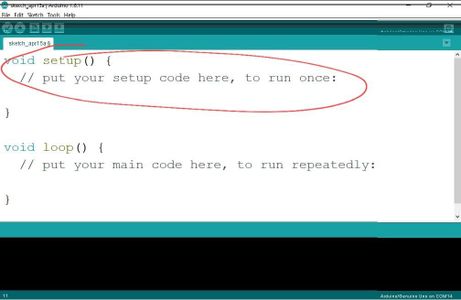

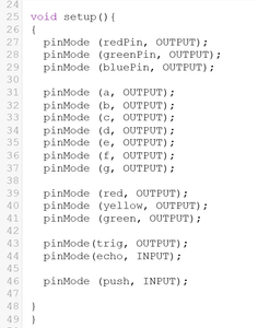

Step 4: Breaking Down the Code - Void Setup
The first part of void setup states which specific components are declared as input or output. The output devices are always declared as output, and the input as input, simple as that. Regarding the distance sensor, 'trig' is declared as output, and 'echo' is declared as input.

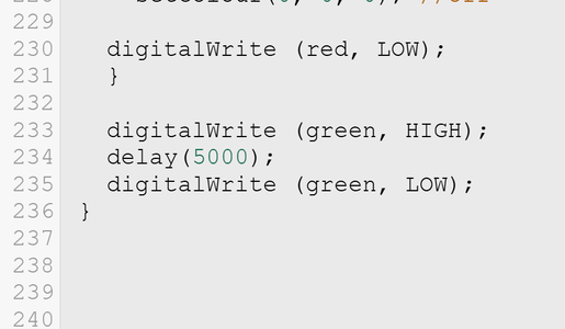

Now, this first portion for void loop includes both the functions for the LEDs and the distance sensor.
The function 'digitalWrite (green, HIGH);' is what turns the green LED on, and 'delay(5000);' leaves it on for 5 seconds. Then, 'digitalWrite(green, LOW); ' turns the LED off. As the code goes on, the same thing occurs for both the yellow LED (for 3 seconds instead, hence delay(3000);) and the red LED all in that specific order. However, with the red LED, there is no 'delay' or 'digitalWrite (red, LOW);' that turns it off - this is essentially because the red LED will stay on while the rest of the code operates. Later on in the code after a specific sequence, the green LED will turn on again. But we're not there yet.

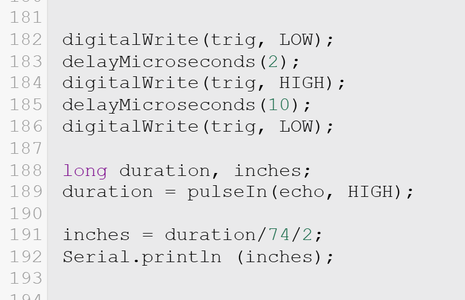

Before we move on to the basis of how the term 'advanced traffic light' comes in, the second image provided shows the function used to measure distance with the distance sensor. The distance sensor essentially operates by emitting an ultrasonic pulse or sound waves and measures how long those sound waves take to bounce back from an object - hence this code being the setup needed to make that happen. As well as that, it also calculates the distance in inches.
  1. Serial.println (inches); allows the serial monitor to print the distance in inches.

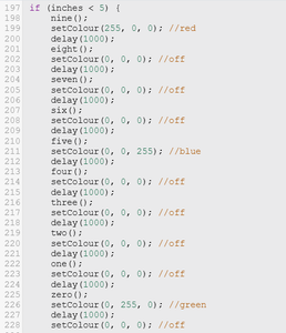

Congratulations, you have made to the very last steps of the complete code. This is the section in void look that will do all the advanced main work at the 'red light'. If you're read the introduction, I'm sure you now have a bit of a grasp on what exactly this project does. When the light turns red, the 7-segment display will start counting down from nine. At 9, the RGB will turn red, then it will turn blue at 5, and once the countdown reaches zero, the RGB will turn green. This code does exactly that in the most simple manner.
This part of the code performs a countdown sequence (from 9 to 0) as mentioned using a 7-segment display and an RGB LED. It is only triggered when an object is detected less than 5 inches away from the distance sensor.
'if (inches < 5) {'
  1. This is an if statement and remains as the main trigger condition, the sequence should trigger because of this function (However, if you would like to remove the distance sensor as an easier method, the code operates without this statement and the sensor as well)
7- Segment Display
  1. The functions nine();, eight();, seven();, six();, etc., control the 7-segment display to show numbers from 9 to 0.
  2. 'delay(1000)' means that each number is displayed for 1 second
The RGB LED
  1. The RGB changes colours depending on what number the seven segment displays
  2. setColour(255, 0, 0); sets the RGB to Red.
  3. setColour(0, 0, 255); sets the RGB to Blue.
  4. setColour(0, 255, 0); sets the RGB to Green.
  5. setColour(0, 0, 0); turns the RGB off.
The sequence first shows 9 displayed on the 7-segment. This is when the RBG turns red, delay (1000) means it waits for one second. When numbers 8, 7, and 6 are displayed on the 7-segment, the RBG is off - 'setColour(0, 0, 0);'. When the 7-segment displays number 5, the RBG turns blue - 'setColour(0, 0, 255);'. Numbers 4 through 1 also have the RBG off, and when the 7-segment display shows zero, the RBG turns red - 'setColour(255, 0, 0);'.

digitalWrite(trig, LOW);
delayMicroseconds(2);
digitalWrite(trig, HIGH);
delayMicroseconds(10);
long duration, inches;
duration = pulseIn(echo, HIGH);
inches = duration/74/2;
if (inches < 5) {
nine();
setColour(255, 0, 0); //red
delay(1000);
eight();
setColour(0, 0, 0); //off
delay(1000);
seven();
delay(1000);
six();
delay(1000);
five();
setColour(0, 0, 255); //blue
delay(1000);
four();
delay(1000);
three();
delay(1000);
two();
delay(1000);
one();
delay(1000);
zero();
setColour(0, 255, 0); //green
delay(1000);
delay(5000);
digitalWrite (green, LOW);
