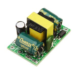

  • 5v Power Supply(you can use old mobile phone charger(currant limit of 500ma), or you 5v battery)
