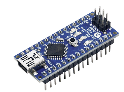

  1. Arduino nano is the brain of the devices, with an ATmega 328p processor. It was chosen because of space considerations, enough I/O ports and low price.

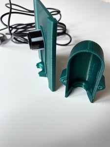

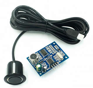

  3. AJ-SR04M is a waterproof ultrasonic sensor which measures distances. It is compatible with HC-SR04 sensor in terms of pinning and software, however the AJ withstands humidity and connects to the main board over a 2m long cable, important requirements for the current project. The sensor sends a burst of ultrasonic waves and using interrupts in Arduino, the time duration until the signal comes back is measured. Given the speed of sound in air, the distance is easily calculated.

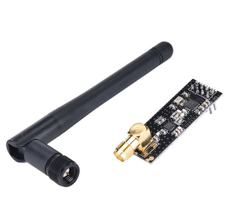

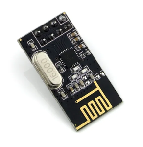

  4. NRF24L01 is used for Master as the receiver. It is a very good and non-expensive solution for radio communication. It is running with 3.3V, however the pins are 5V resistant.
  5. NRF24L01 + PA + LNA is used for Slave as the transmitter. Unlike the NRF24L01, this component possesses an antenna that enables communication ranges of over 1 km, the main reason for usage over the standard version. It is running with 3.3V, however the pins are 5V resistant. NRF24L01 and NRF24L01+PA+LNA are interchangeable, no modifications in circuitry or software are needed

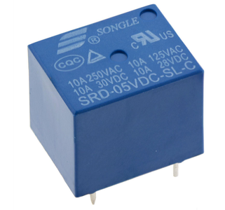

  6. SONGLE relay is used to power the water pump. It is controlled by 5V over a transistor and not directly over Arduino pins (higher current needed than what Arduino pins can deliver) and can control an output of 250V AC and 10A, enough for pump specifications.

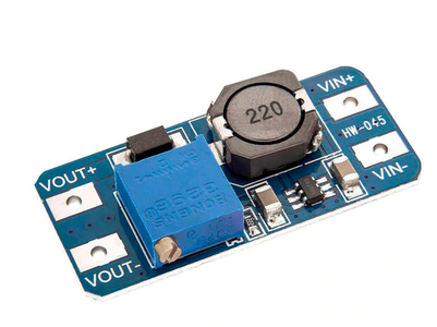

  7. Boost converter MT3608 is used only in Slave to supply a constant input voltage of 5V. The battery voltage varies between 3V (empty) and 4.2V (full), hence the need to increase the voltage to a constant 5V. The module offers a variable output voltage, so using a screwdriver turn the screw until the 5V voltage output is set.

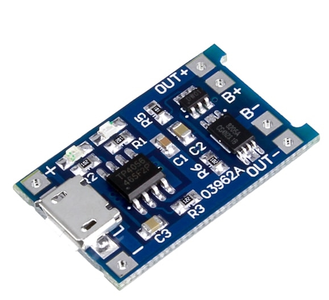

  8. Charging module TP4056 is used only in Slave to charge the battery over a solar panel or micro-USB. The charging will be by default over the solar panel. It is a very effective module that delivers up to 1000mA current and has overcharging protection. Normally you're not allowed to run the Slave while charging (the module cannot then calculate the charging current) but since the Slave consumes such low power, I've tested it and it's fine. The red LED indicates charging, while the blue one that charging is complete.

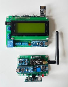

The idea of the Advanced Water Management project has crystallized around a master-slave architecture, connected by radio communication.

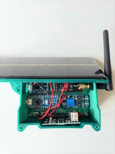

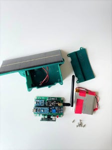

The Slave
Its main purpose is to measure the water level in the tank and communicate it to Master.

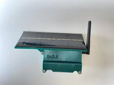

It runs on a battery which is charged permanently by a solar panel, therefore as long as the sun is shining, it is completely autonomous. A function inside permanently monitors the battery state of charge and communicates it to the Master.
The measurements are communicated every 4 minutes, independent of whether the master listens or not. However, since it is synchronized with the Master (they go to sleep after a cycle always at the same time), the latter "scans" the air in the same interval as the Slave is sending.

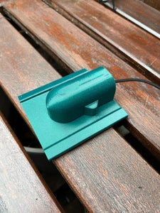

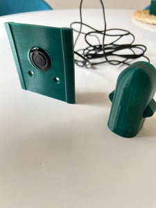

Measuring the distance is done using a moisture-resistant ultrasonic sensor at the end of a 2m long cable. The sensor sits in its own casing and is mounted on top of the water tank. The other end of the cable is connected to the main board of the Slave.

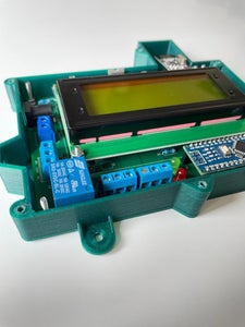

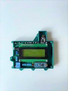

The Master

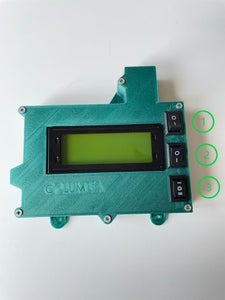

The main purpose is to display the measurements from the Slave and control the water pump.
It uses an external 7-15V power supply and unlike the Slave which can be deployed anywhere on the field, the Master positioning is more limited, because it has to be around a power socket and the pump controlling power line.
It uses a 20x4 LCD display to show the water level and battery state communicated by Slave and other forecast/timing information.
When the water level is below a threshold (parameterizable - see step Software) the pump signal is set and remains on until a new threshold is reached (again, a parameter). There are three possibilities of pump control, using a 3 pin switch:
  • the pump is always off
  • the pump is automatic - the software decided when to turn on and off the pump
  • the pump is manual - the user can anytime switch the pump on
Status LEDs indicate when the water level is below the "empty" threshold or when the pump is running.

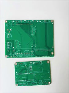

Step 3: Circuitry and PCB Ordering / Preparation
In total, we have two separate circuits, one for master and one for slave.
The schematics for both units are found below.
The Gerber files can be downloaded from here.
I've ordered the PCBs on PCBway, they came in a few days and work great!

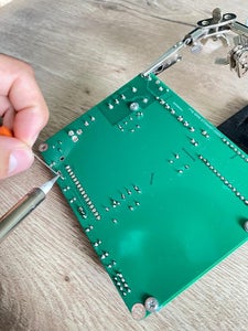

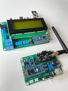

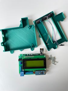

Step 4: PCB Population
With PCBs arrived and all other components available, the boards can be assembled.
Don't solder the Arduino boards and the radio modules directly on the board, so that you have the possibility to remove/change them if necessary.
Programming the slave is not possible without removing the microcontroller, since the casing is in the way.
Therefore please use strips soldered on the board, see pictures ;).

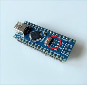

  • Reduce the Arduino board consumption by putting it to sleep when not needed - I found a great post from Donal Morrissey regarding this.

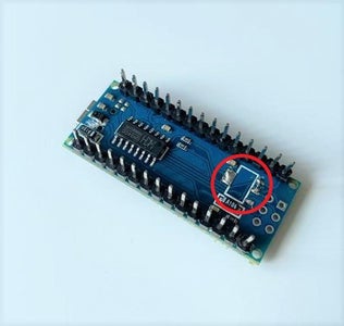

  • Removed unnecessary consumers on the Arduino board - such as LEDs and the linear voltage regulator.
The library PowerManagement.c contains the functionality of putting the microprocessor in deep sleep mode.

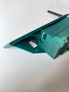

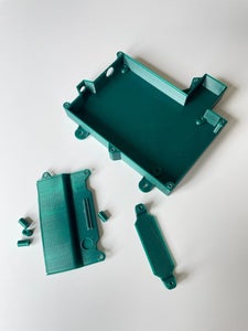

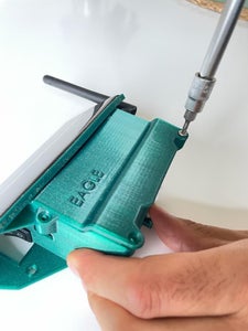

Step 8: CAD: Design, Slice, Print
The design of the casings was a highly time-consuming effort since everything had to come together perfectly.
I've used Solidworks for design and UltimakerCura for 3D printing preparation (slicing).
As for 3D printing, I've used the standard setup recommended by the tool.
You can download the 3D parts from here.

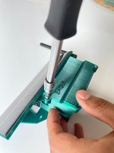

Step 9: Assemble Components
With the complete boards and available casings, the last step is to marry them. I find it the most rewarding step, as everything comes together and finally looks like complete devices!

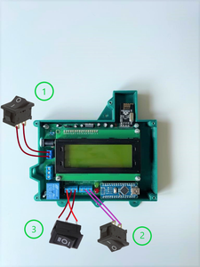

Step 10: Connection of the Pump and Field Operation
The last step is to set the equipment in place and connect the water pump (the pump in the schematic is only an example, it is not the used part). The design offers the possibility of a nomally-open and normally-closed circuit for the pump circuitry. We'll use the normally-open (lower 2 pins in the connector, see image), since without any intervention the pump is by default off.
Please be aware that the relay can handle a max. voltage of 250V and max. current of 10A!
As mentioned in previous steps, with the lower 3 pole switch you can set the pump into automatic (software controls when to switch it on or off - position I) or control it manually (position II). With the switch in neutral, the pump is permanently off.
The Slave was fixed on the nearby wooden cabin and the sensor cable was protected with a flexible tube. The sensor itself was placed on the tank cover, over a hole that permits the measurements. How you fix the sensor on the cover is up to you, you can even screw it down.
