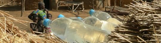

First, you'll have to fill up the clear plastic bottles with the water that you mean to disinfect, this could just be water from wells or some other source that may not be fit for drinking. It's fine even if it's just that you're unsure about what to do to make sure that the water you drink won't make you sick.

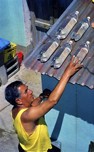

Step 2: Placing
After you fill up the plastic bottles and screw the lid on, you'll have to place them somewhere where there is direct sunlight and no shade. Make sure that the botlles are completely exposed to sunlight and no part of the bottle is covered, remove the labels of the bottles if they are opaque and do not let sunlight pass through.
Step 3: Patience
The final step is the longest one, you'll have to wait for 6-8 hours so that the water is properly disinfected by the sunlight and is completely safe to drink. Once the hours are finished, you can be assured that the water is safe to drink.
