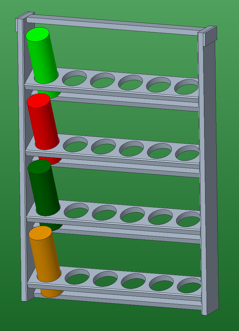

Aerosol spray can holder that holds 24 Cans of varying lengths that fits between a 24" on-center wall stud. Made from one 2x4 for the One Board Contest (PDF of a print included)

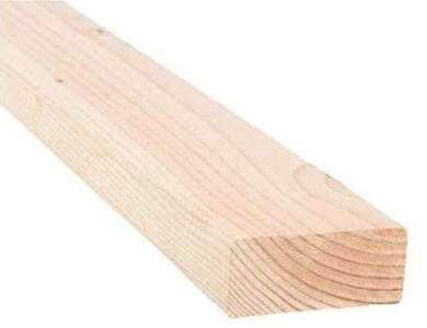

  • One 2"x4"x8'

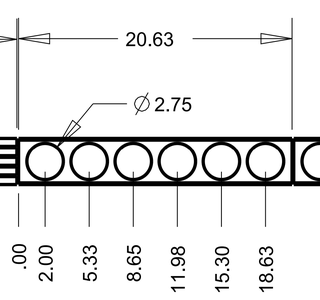

  • One 20.63" board into 5 equal pieces 0.6" wide
  • Two 20.63" boards rip in half the long way
  • The 32" board rip in half the long way
Step 3: Drill Holes
  • Clamp boards down and drill holes at 2.00", 5.33", 8.65", 11.98", 15.30", 18.63"

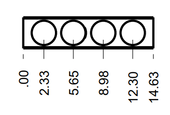

  • (Optional) 16" on-center board measurements length 14.63", holes at 2.33" 5.56", 8.98", 12.30"

  • Mark 32" boards out with a lines for the correct angle (65°) and spacing, starting from the bottom mark at 0.63", 2.95", 6.13", 8.13", 10.45", 15.63", 17.95", 23.13", 25.45"
Step 5: Drill, Screw, Glue (or Nail)
  • Glue ends of inner boards and screw together (or use nail gun)
  • Glue and clamp stop pieces on the top
Step 6: Installing on Wall
  • Screw a screw into studs at appropriate height, lift onto wall and enjoy!
