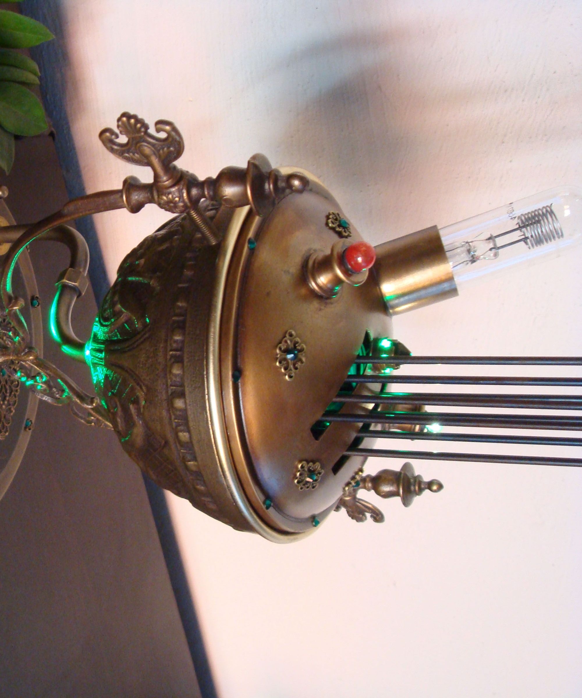

Now we put two Ball Bearings into the Lamp Owners.One solo and one with a Gear. ( The third Pic.). The Gear must be cutting in Form of the Ball Bearing inside and attach briefly with quick glue. Later we use the Resin inside the lamp Owner and stick together but only around the Ball Bearings !!!!!!

While the wood is at the dry, we prepares the Engine for the rotating Cage. Take a Head of a welding Torch and prepare it for 3 Cables. 2 for the Motor and one for the Geissler Tube Contact. It can be that must everything be drilled out depending on which torches were used. Prepare a Copper Tube for the Motor inside. Drill 2 small Holes. One for the Motorcable and one with a 2 or 3 mm Thread for a Screw to fit the Coppertube with the Motor inside at the Torch.It must be attached with the gear wheel suitably. Now we have the two Holders for the Geisslertube.

Now we assemble all. In another Part from a Lamp we put two Switches. One for the Light an one for the Motor. Inside the Lamp Holders now looks the Cable. Over these Cable we put a small Acrylic Tube with a Battery Spring.
The Springs hold the Tube in their Situation and press it away from the Housing.
