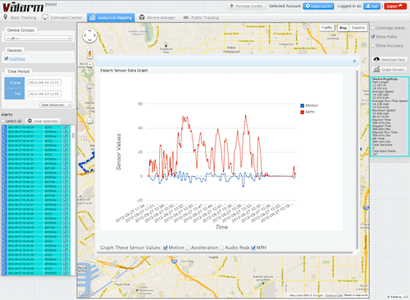

Step 4: Web Tools for Tracking
Now that Valarm is armed, you’re tracking!  In the screenshot above auto-upload to web tools is enabled so all data can be visualized and analyzed at tools.valarm.net as seen below.
