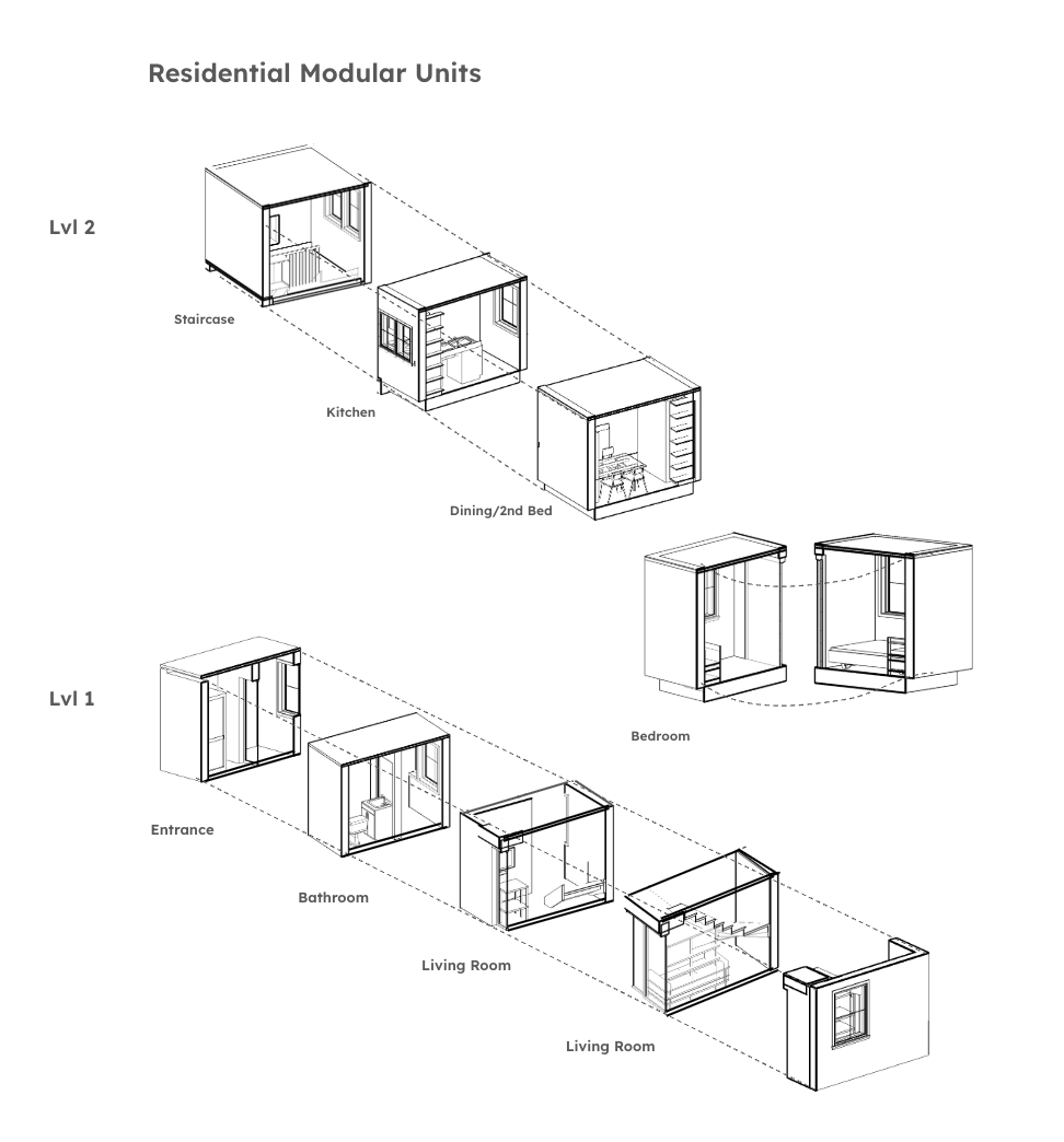

The units are prefabricated into smaller sections according to the space usage (image 1). The MEP (Mechanical, Electrical and Plumbing) systems are also prefabricated: The raised floor system contains Electrical and Plumbing systems, and the energy systems are in the prefinished ceilings (image 5)
After prefabrication, the modules are transported by truck to the site (Image 2). They are then assembled into units on site, each unit stacking on top of each other as indicated in image 3.

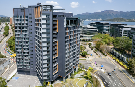

Before designing my project, I conducted extensive research on existing MiC projects in Hong Kong, Tokyo and Montreal: Innocell (Image 3), Nakagin Capsule Home (image 2) and Habitat 67 (image 1).
All of these projects utilized modular pods/capsules that could be rearranged and stacked, inspiring me to use legos to brainstorm possible design configurations. Habitat 67's stacked concrete modules creates unique terrains and outdoor spaces. This idea inspired me to stack the modules in a way to similarly create outdoor spaces such as balconies.
Nakagin Capsule Home's concept of plugging in modules inspired me to overlap units like a Jenga tower, while InnoCell's highly efficient construction process, completed in only 14 months (which was 6 months ahead of schedule), led me to research more thoroughly how modular integrated construction can save time as well as reduce material waste and cost less.
