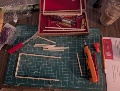

Computer
Revit
Clips
Ruler
Wood glue
Blade
Hammer
Wood driller
Nails
Brass wood stick
Paper
Foam Board
Plastic Sheet

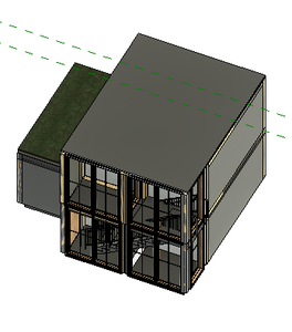

For the next step I had to decide how to create the house based on how many people are going be there, costs and time of building a house, and impact of the house environmentally. I knew the problem dealt with people not being able to afford houses so it wouldn’t be efficient if one person paid for a house with so much space. This is why I decided a modular house would be a good idea. Families can live in a house with 2 floors and more bedrooms or one person can live in a house with a floor and one bedroom. I also knew that another problem that needed to be addressed was the environmental component. The house will be created out of wood from pine trees which grow very fast which makes wood from pine trees very sustainable and efficient. I also use glass to decrease the need for artificial lights in the modular house. I also have solar panels on the roof of every module of the top level so the house will be supported by solar power. Another problem the house had to deal with is efficiency with production. Since it is modular houses the house would be created in a factory. This will speed production because it can be created in any type of weather or time. These modules would then be shipped to the spot where the house should be placed. Trucks can only ship modules under 8 and a half feet which is why I chose to have the length of the module as 8 feet. I planned to create two different type of modules. An 8 feet by 16 feet by 8 feet
module and an 8 by 4 feet by 8 feet module.

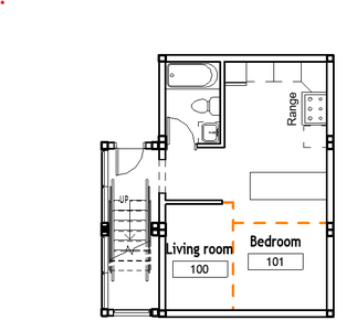

Step 3: Floor Plan

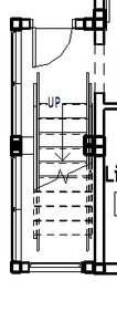

For the floor plan, the first level with no modules added on to the modular house there is enough space for two people to live. The first level is created with 3 8 feet by 16 feet by 8 feet modules to create a 24 feet by 16 feet by 8 feet rectangle and a 8 feet by 4 feet by 8 feet modules behind the entrance. In the first level there is a bathroom, a kitchen, a living room, and a bedroom. The 8 by 4 feet by 8 feet module is made with 3 glass walls with a door. The bathroom has a bathtub, a toilet, and a sink. If the owner wants to have more space then a second floor will be made of two 8 feet by 16 feet by 8 feet modules next to each other and 3 more 8 by 4 feet by 8 feet with stairs inside to go to the second floor. The floor space created by the area not covered by the two 8 by 16 by 8 modules will be turned into a patio with grass. There will be solar panels on each roof of the two 8 by 16 by 8 feet modules on the second level. I created the floor plan on Revit and on paper. The picture of the stairs how more 8 feet by 4 feet by 8 feet modules are put in so the stairs can go to the second level.

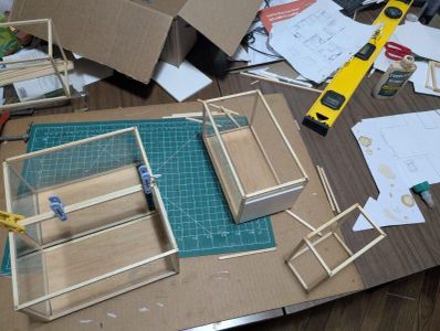

Step 5: Finished Model
The finished models show how the modules join together to make one nice space for people to live in. It also shows the different ways someone could choose to have the house made. Since the modules are made in factories it is very easy to move modules and take off modules from the building. I built this model to try to create a house that is affordable for people or families and putting them in a location that made it easier for them to be in.
