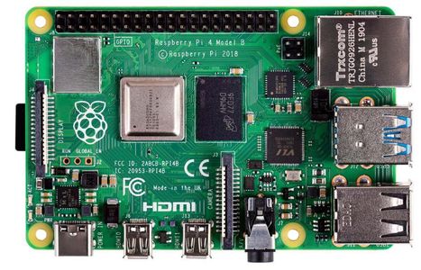

  3. Rasberry pi 4 $45

Step 8: Load Software Onto Raspberry Pi
Download Raspberry Pi imager to upload software onto a Raspberry pi. Select the Raspberry pi device, then select Operating System and choose Retropie. Make sure to select the version of Retropie that correlates to your Raspberry pi model. Connect a micro sd to your computer and select the sd card under storage. Finally click next and choose whether you want to change additional OS customizations then select yes to continue. If you want to download game files over the internet, enter your wifi network and password under the addition OS customization.
