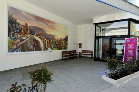

Arriving at Roland DG Mid Europe head office, people are fascinated by a wonderful fresco applied on the wall just before entering the company.
It is not wall paper, but a particular application that allows to transfer just the colours inside the pores of the wall. The media, in this case a fabric, will be removed at the end of the process and the colour will be perfectly soaked up from the wall. The result could be subsequently protected, integrated and embellished with the commonest protections and paints for decorations.
The idea of this digital fresco was born last year, when Roland DG Mid Europe was restoring its building and this big wall was so empty. Being Roland one of the biggest producers of large format machine, why do not exploit its own abilities and capabilities to decorate and beautify its seat?
The chosen image portrays a battle and its creator, the professional illustrator Ivan Stalio, was happy and proud to offer his work to create this epic application.

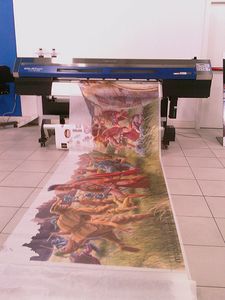

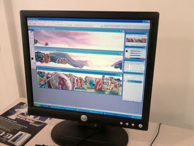

Putting the project into practice was not so easy. The first problem concerned the panelization. After some tests made with the firm Shockline, producer of the printing media PS Fresco, it was decided to use a panelization for dynamic graphics. The file was duplicated and the technicians had to create some guide lines based on the maximum printable area in height. On each panel it was selected a graphic continuity based on the contrast, deleting the parts that would have been printed on the upper panel.
Once the PS Fresco had been uploaded, the technicians started to print the graphic with a Roland XC-540 at standard quality.
Il primo problema era legato alla pannellizzazione. Nel posare l'affresco non potevamo usare il sistema di sovrapposizione utilizzato per le grafiche che superano il formato massimo di stampa. Da esperimenti effettuati con Giuseppe Biondi della Shockline, produttore del materiale di stampa PS Fresco e partner in questa posatura, si è deciso di usare la pannellizazione per dinamiche grafiche.
In pratica abbiamo duplicato il file e creato delle linee guida basate sulla massima area stampabile in altezza. Su ogni pannello abbiamo selezionato una continuità grafica basata sul contrasto cancellando le parti che sarebbero state stampate nel pannello superiore.
Questi i tre file da mandare in stampa con la pannellizazione basata sull'immagine.

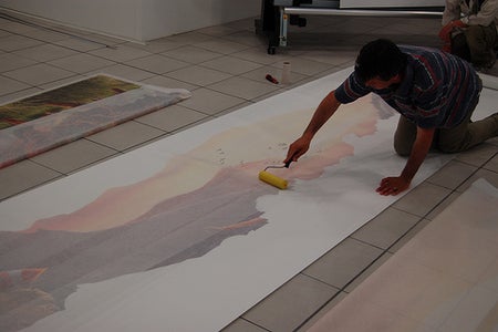

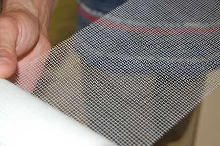

Prima di posare si è preferito incollare sul retro delle stampe una reticella adesiva per evitare le distorsioni dovute alle successive bagnature e stiramenti della stampa.
E' preferibile utilizzare un rullo morbido per far adesivizzare al meglio la reticella sul retro del supporto.
Conviene rifilare il decoro (stampato con effetto specchio) al formato richiesto, a filo sul colore se possibile, e piegare a fisarmonica il telo dal lato del supporto in tnt, lasciando il lato stampato libero.

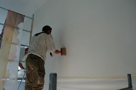

The day before applying the graphic, the wall had been checked to make sure that it was in good condition. Then, the technicians treated the wall with particular materials and after about three hours they finished with a lick of white paint.
Il giorno prima avevamo verificate lo stato della parete, la solidità e la capacità di assorbimento. Dato che era una parete in buono stato, abbiamo proceduto alla stesura di una mano di fissativo impregnante consolidante acrilico diluito con acqua dal 100% al 300% secondo necessità.
Per pareti non consolidate o sfarinanti è consigliabile eseguire cicli di consolidamento adeguati. Ricordatevi che una buona applicazione dipende in gran parte dalla preparazione del fondo.
Dopo circa 3 ore dalla mano di fissativo, Cesare, il nostro imbianchino, ha preparato la parete con due mani di BIANCO ACRIL SILOSSANICO. Ha finito alle 18:00, siamo andati a casa sicuri che l'indomani avremmo trovato una parete perfettamente asciutta e pronta per accettare l'applicazione.

A questo punto bisogna bagnare la parete con la MISCELA ACRILICO ACRIL SILOSSANICA realizzata come sopra, dando più mani con pennello fino ad avere un velo uniforme di liquido sulla parete su cui posizionare il pezzo. Ricordarsi sempre che il prodotto lavora come decalcomania, pertanto la superficie molto bagnata ci servirà per l'eventuale removibilità e riposizionamento del decoro. E' importante avere un cuscinetto di liquido durante l'applicazione.

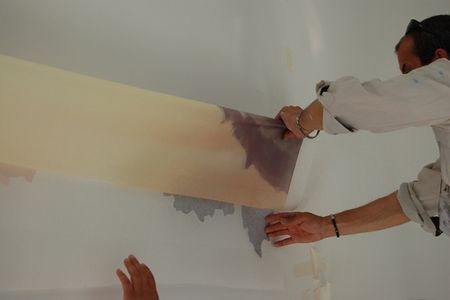

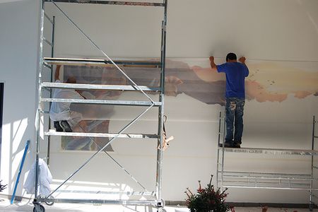

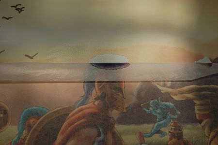

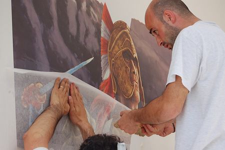

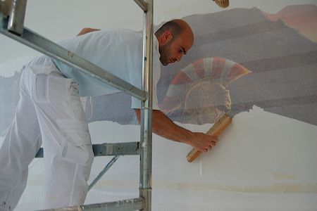

Sulla parete molto bagnata posizionare il telo con il decoro prendendo i riferimenti e posizionando il telo piegato a fisarmonica con tecnica da carta da parati leggera.
Con una spazzola per parati stendere il telo attaccando leggermente una parte orizzontale in alto, poi con movimento uniforme e continuo spatolare per far aderire dall'alto verso il basso e poi dall'interno verso l'esterno. La spazzola dovrà essere usata asciutta. Qualora il telo faccia delle pieghe, riposizionare e ristendere con la spazzola, velocemente. Nel riposizionare per togliere le pieghe è possibile bagnare ancora la parete per aumentare la riposizionabilità. Non bagnare il retro del telo in questa fase.
Una volta posizionato (eseguire in pochi secondi), occorre togliere velocemente l'eccesso di acqua ed aria che si è formato tra il telo e la parete. Utilizzare un rullo in gomma morbida, del tipo usato per l'applicazione di parati. Usarlo con movimenti dall'interno verso l'esterno, assicurandosi che tutta l'acqua in eccesso fuoriesca e venga espulsa.
Step 5: Off Water - Battitura

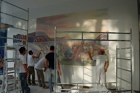

The following morning, the wall was treated again with different materials and then, finally, the application.
On a very wet wall, the technicians positioned the fabric and after a few seconds the excess water and air between the wall and the fabric had to be removed.

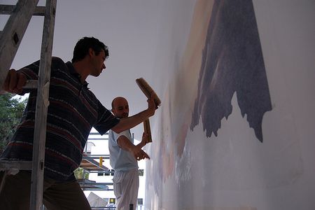

Dopo l'operazione con il rullo si dovrà bagnare abbondantemente il retro (il supporto in TNT) con un pennello o una spazzola, con la stessa soluzione usata per l'applicazione (miscela acrilico acril silossanica diluita). A questo punto, attendere 10 20 minuti, il tempo che la superficie diventi leggermente appiccicosa e tamponare ripetutamente con una spazzola per far aderire perfettamente il decoro alla parete, nelle rugosità e nelle imperfezioni della parete. Per superfici difficili o volte, dopo la tamponatura passare un rullo in lana asciutto per far aderire il telo al soffitto, contrastando l'azione di gravità che può generare distacchi del telo dalla parete.

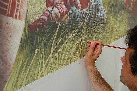

Attendere almeno 6 ore, meglio 12 o 24 se la temperatura è bassa e l'umidità relativa alta. Poi bagnare il telo ancorato al muro con acqua tramite pennello, rullo o nebulizzatore, aspettare qualche minuto e rimuovere il supporto tessile. Continuare a bagnare durante la rimozione per ridurre la forza di adesione del telo alla parete.
