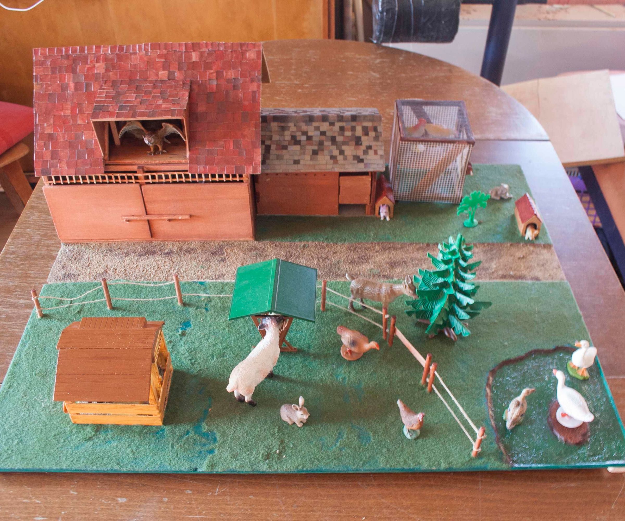

Step 21: Finished Diorama
That’s it! The point of this whole project is to enjoy it and for you child to enjoy it. These instrucions are more guidelines than rules, let your imagination go!
