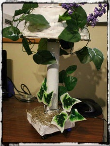

Here comes more fun! Time to put your creativity to good use. Decorate the lamp with all the various plants you have gathered. You can easily weave the plants and vines through the basket; another good reason to use one! ;) This part is especially up to you how you want your lamp to look. For me, I want an elegant and almost graceful looking lamp. I added a few flowers and different leaves and vines to help tie it all together. I also added some Spanish moss on the base to give it more of an earthy look. This lamp is one that must be effective as a lamp and yet glowing with lush plants when the lights go out.

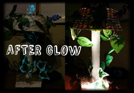

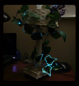

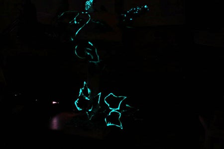

Now this is something I found on ebay for 5$. I read that it glows blue and works pretty darn well when exposed to a little light. It is a white color when you first put it on but never fear, it will dry transparent. Now all that's left to do is cover your leaves and flowers with it; however much and however little you want! For me, I like that Glow. ;) Remember when I made my lamp white? Well I did this because white is an excellent reflector of light and will thus help my glowing pigment, to GLOW. Allow it to sit in good light for at least an hour. The flashlight will do its job and make them glow but if you really want the "Avatar" look you may need to let it soak up some more light.
Step 10: The After Glow!

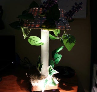

Your final project should look elegant and alluring! Especially when the light goes out. When it's on, the lamp is bright enough to read by. To me I found it very calming. You could also use this as a beautiful decorative piece for special occasions or simply on your back porch. The plants help tie in the whole out-door feeling!
