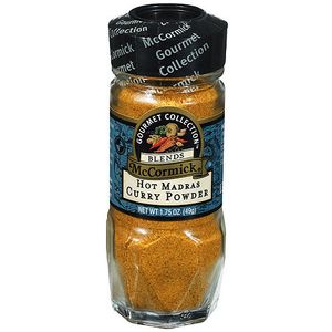

DIRT/DUST: I like to use a mixture depending on what type of dirt I'm recreating. I use what I call "dirt puffs" which is just whatever dirt I need mixed up and poured into an old nylon doubled up. Tie the top of the nylon and it becomes an easy way to "pouf" dirt onto whatever you need. You can bop it against just about anything and get a nice dirt look or even shake it over for a light dusting. To get your dirt fine enough to sift through a nylon and to ensure it's well blended, I like to pulse my dirt ingredients in an old coffee grinder before nylon bagging it.
MAKE SURE YOU'RE BEING SMART WITH THIS STUFF...even though it's all kitchen items, it's still not healthy to breathe it in, so make sure as you're "pouffing," that you're not inhaling a ton of it either.
DUST: Baking flour
DIRT: Instant coffee and or tea
RUSTY DIRT: Instant coffee and cinnamon
SANDY DIRT: Instant coffee and curry
MUD: flour, instant coffee and any of the above ingredients mixed to a nice slurry and then spattered or slapped onto whatever you want.
