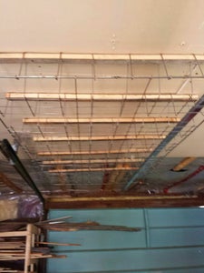

I was cleaning out the garage and about to throw out the box springs when I noticed a nice wood grid in the back, which worked out perfectly, because I was also looking at a pile of pallet boards I needed organized and off the ground somehow.
One of the box spring I dismantled had a steel frame inside which I turned into overhead storage for my steel corners and wood dowels. Killed two birds with one stone, got rid of the box springs and organized my wood and steel supplies.

Now let's do something with that metal rack that was left behind from the one box spring.
Step 4: Cut Strapping Studs, Find Your Stud and Straps, Ohh You Know What I Mean. Lol
(***Be careful with installing anything over head, I am not responsible for anything that may happen from you trying this or any of my instructables.***)
We first need to cut strapping that is a bit longer then the width of the box spring frame, and it must fit in between the metal bars. Don't use cheap wood here because it must be strong enough to support the weight of whatever your storing in the racking, you dont want this falling on your head.
With your new strapping you need to find your ceiling studs and make sure you screw your strapping into studs, thus sandwiching the metal rack against the ceiling to support whatever you want to store.
I primarily used this for all my metal corners, round dowels, long wooden handles etc.. You go ahead and store anything you can fit in there.
