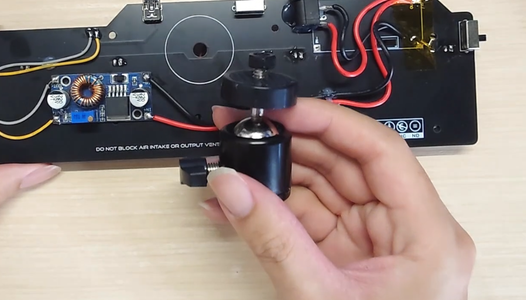

The PCB power circuitry for the fan consists of two power source. One is the input power (5V) and another one is 12V that is boosted by a XL6009 buck boost converter. However, I think I got a fake one online which cannot actually output the 4A it claims on its website. That is why later I switched over to another module with XL4005E which only provide buck conversion. In order to compensate for the required voltages for the PCB to operate, I added a 12V input jack for the HIGH power mode and use the buck converter to provide 5V for the LOW power mode.
Step 3: Power on and Testing
After the circuit is tested with a multimeter to ensure nothing shorts, I powered it with a 12V 2A power source. The fan is much quieter than I expected and I can easily toggle HIGH / LOW power mode from a switch on the left hand side. I also left a 6mm hole in the middle of the PCB for mounting it to the top of my monitor using a cheap ball joint I tear down from a selfie stick. However, I still don't have idea how to mount it to my monitor yet as I just notice my monitor didn't have a flat backplate...
